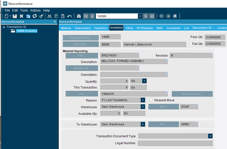

We had 3 inventory nonconfomances created for the same part. All were passed in inspection processing. One of the NCRs looks good with a STK-INS and INS-STK transaction. The other 2 have STK-INS and INS-ASM transactions. The problem is that there are no jobs for these to go to. Where should I look to find these parts and how do I get them back into inventory? Part Transaction History shot below.

If these were nonconformed again ‘Inventory’ then they won’t go back against a job, once processed via Inspection Processing they’ll appear back in the Inventory location.
Are you sure the other two were nonconformed against Inventory?

Yep, they are Inventory non conformances.
Part tran history shows STK-INS and INS-ASm transactions. INS-ASm shows blank in the job field. I created BAQs agianst the Non conformance table, the Part Tran table and the Job Material table to try to find a clue and have not been able to locate anything helpful. I did get the transaction numbers from the Nonconformance table but not sure how they might help.
