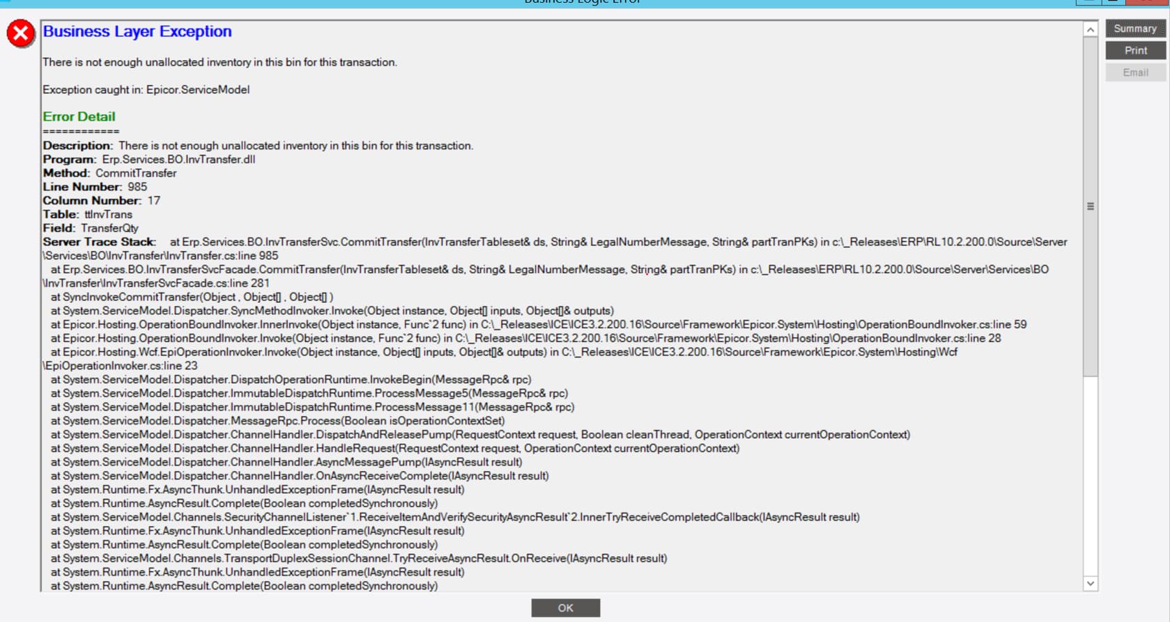

Getting there is not enough unallocated inventory error when trying to move one part from one warehouse bin to another.
scenario:
Intercompany receipt done (Po having SO reference) and now need to move the item from my receiving area bin to shipping area bin.
Please suggest how to achieve this as inventory needs to move between bins with in same warehouse.

Hi Jonathan,
PFB error
need to move parts from one bin to another after receipt (Po is having SO link).I found one work around to move from received bin to shipping bin (STK-SHP) and then unpick the sales order. After this i can do normal inventory movement request process and move between bin locations.
