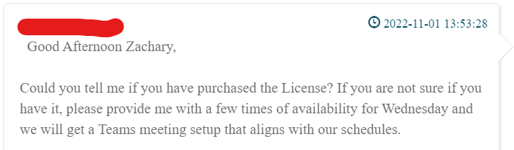

I was called and told that this required the Planning by Revision license. Now I’m being asked about the Advanced UOM license. Their release documentation states in two places that this feature is out of the box, but support keeps bringing on the licensing.

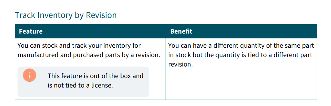

From Kinetic_WhatsNew_2022.2.pdf

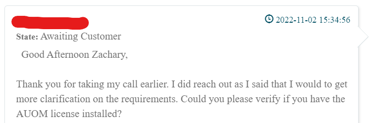

Update: Epicor support lead is adamant that this now requires the Advanced UOM license, despite their own release information and being told that it requires the Planning by Revision license initially. The feature still works without such licensing.

Per the higher ups
"If you just want inventory by revision – this is out of the box
If you want to Plan by Revision (MRP) – this is a license
If you want to turn on inventory by revision on an existing part, you go to Part UOM Conversion screen – but once you turn it on, you cannot turn it off."
