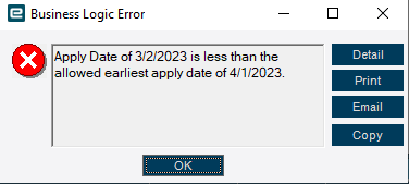

If you set the earliest apply date, you will find out real quick how they are happening because the person will come asking why they can’t do what they want. It is under General Ledger/General Operations.

As @jkane said, once you change this you will quickly find out where it is happening.

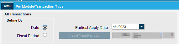

There are multiple options for Earliest Apply Date. On the main screen you can set the general date:

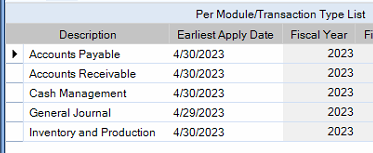

Then in the Per Module you can make that different:
So this would prevent any transactional data to be applied to the previous month, but since you don’t define “General Journal” on this tab, they can still do back to 4/1 to finish their entries because that is caught by the “All Transactions” setting.
So go through and get all shipments, receipts, invoice batches, and labor tickets processed. Run your capture and then set the EAD. Of course, your process may be different.

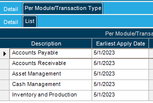

At this time we can set all modules except GL to the first day of the current period and GL to the first day of the previous period. We actually do it when accounting comes in on Monday morning.

@Doug.C There must be a setting somewhere, but we have General Journal also on the module tab.
Yeah, you definitely need to get accounting involved to see what they want. As @Doug.C said, you can control the modules separately. You will probably want to lock down everything except AP and GL, then lock AP, and finally GL.
that sounds about right John, I’d have to figure that out.
Yes, but if you don’t add a module it falls back to the “All transactions” tab setting.
