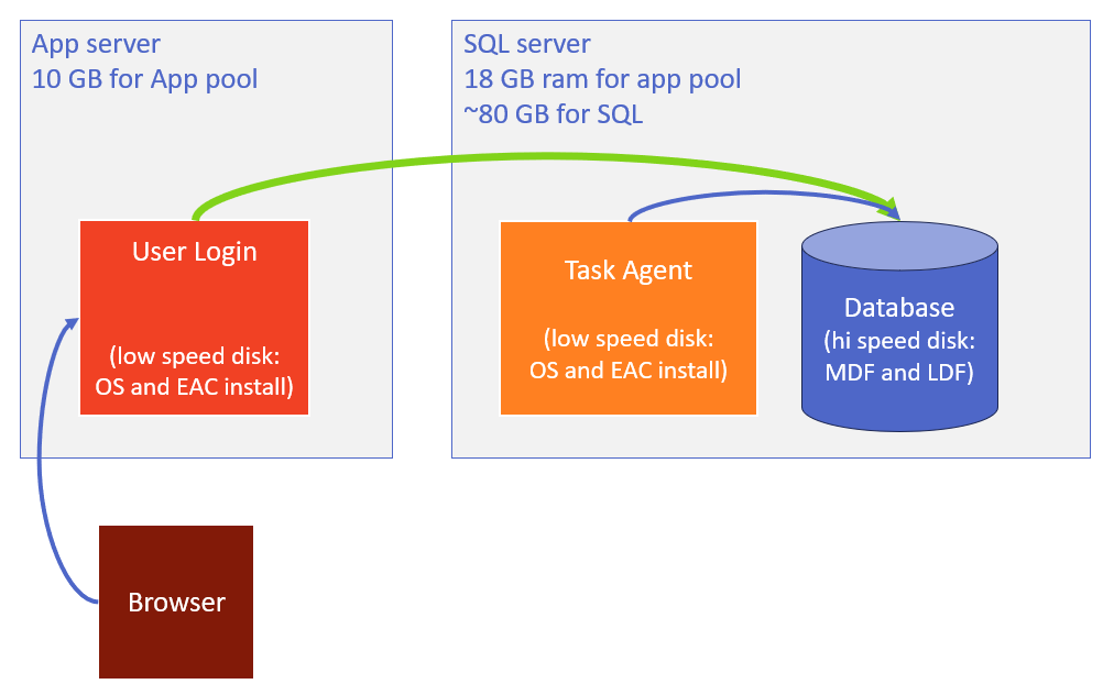

At the same time, we switched to a new architecture, with the task agent on the SQL server and then a separate app server for logging in (but all on the same VM), like so:

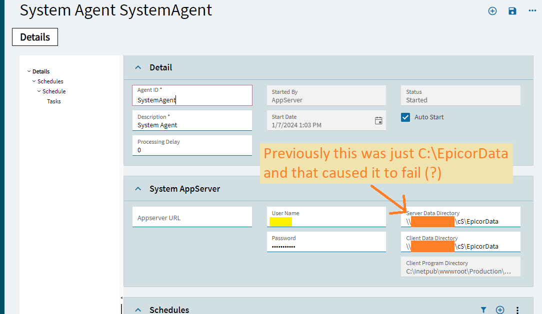

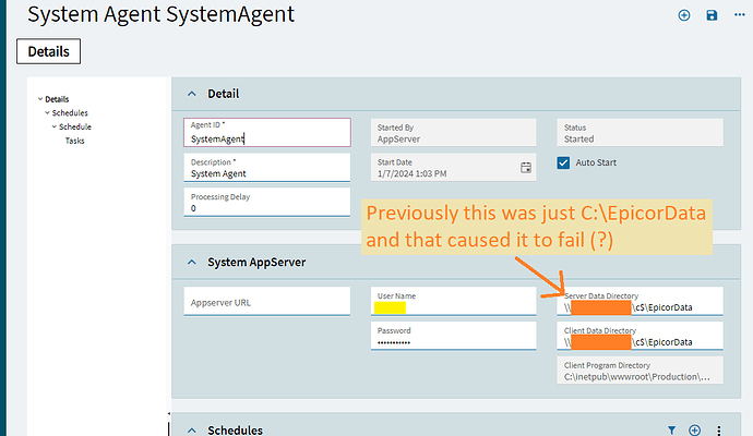

I opened a ticket with support about issue #2 and they said to change the System Agent like so. And that fixed 1 and 2. So, Excel was a surprise - apparently it routes through the Task Agent now when used in the browser. You can see it in the SysTask table.
But the real surprise was that after that, the eCommerce site was fine also, and has been for over a week now.
So, do REST calls go through the System Agent?! Sure seems that way!

The call is to the app server, but the task agent is on the SQL server.
Reports go through the task agent. So if you rest call makes a report, then yes, it uses the task agent. If it doesn’t make reports, then you just need the app server.
Export to Excel is using the report service.
