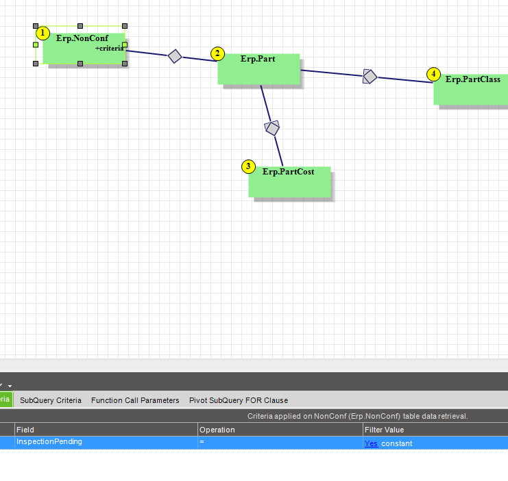

I have a BAQ that shows all parts still pending inspection. See below:
My BAQ results show as follows:

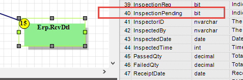

But when i run the canned Inspection Pending report in E10, i get these records:
So I cannot figure out why the PO receipts are not showing up in my BAQ.
Any ideas?

Rcvdtl.2017-12-01_9-12-40
How can I connect that to my current BAQ, relationship-wise?
You can make it be another subquery and then union with your first query.
The common table would be part, but I would not try and create this as one big join.
Make sure the result column names are the same.
