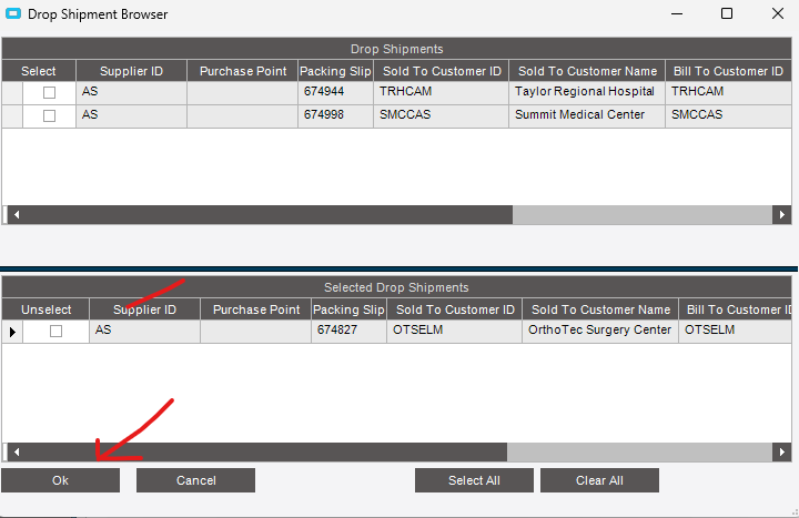

I am working on a ticket to help accounting with a problem on adding a Drop Shipment to an invoice group.
There is nothing interesting about this particular drop shipment.

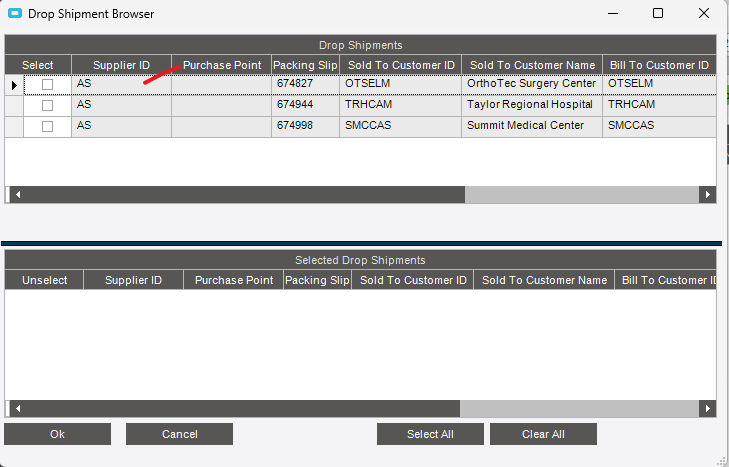

When I select the dropshipment in an invoice group (via “Get Shipments”), I select the shipment
Select it, and click ok
A modal dialog asks “Are You Sure” and I click OK.
Then an exception is thrown:
In the app server logs, the error is as follows:

Insofar as I can tell, there is nothing interesting or unique about this particular drop shipment. I have even tried re-creating the entire drop shipment from scratch and the issue persists, even with an entirely new pack slip.
Any help or workarounds are appreciated

The DropShipHead.ShipToNum that uses OTS usually has a format like OTS00000/00000. I would bet the OTSELM pictured above has a similar ShipToNum beginning? Maybe it starts with OTS but doesn’t follow this format?
The CopyShipHedOTS() first looks for the ShipToNum starting with “OTS”. It pulls the first number from ShipToNum.SubString(3,5) which is the POLine, then ShipToNum.SubString(9,5) is the PORelNum.
If your ShipToNum starts with OTS then it thinks it is an OTS shipment and you’re receiving the error.

re: One Time Ship to, we do not use that functionality and the order is not marked as such, but I am wondering if perhaps there is a hidden character in there somewhere? Both you and Dough mentioned it and I’m curious what leads you both to believe it. It’s a lead worth pursing…
Ohhh you know what the ship to ID does start with OTS(ELM) and I bet that’s exactly what this is. What the hell Epicor lol!! Perhaps they should use something a little more indicative of a one time shipment rather than reading a magic string, and of course there is no indication that we should not have prefaced an account with OTS anywhere, wow.
