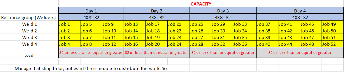

Hi Joe,
Thank you very much for sharing some of the great insight. In our case
jobs are all start to finish and should be assigned like one job to one resource. Meaning, we dont have more than one resource work on the operation. i kind of made a excel model (expected). We surely can do some level of shop floor management of the work. But I want it to show up on the resource scheduling board as level loaded schedule, so i could use dates to plan the delivery schedule of trucks we make.
