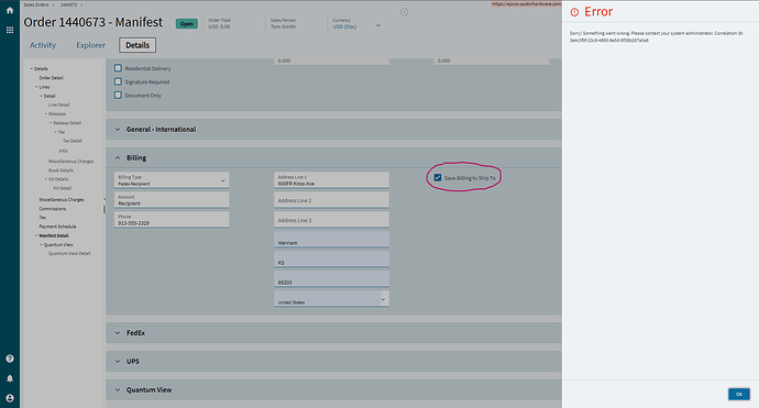

I have a BPM on SalesOrder.Update for creating a new ShipToMFBill when a user checks a UD checkbox on a SalesOrder. The Manifest Billing info of the Sales Order is used to create a ShipToMFBill for the Customer and ShipTo selected in the order and then Update that Customer. Because creating a ShipToMFBill is part of the Cutsomer BO, the BPM calls a Function to do the work external to SalesOrder.
The issue I’m running into is that the function works when calling strictly over REST API, and the BPM works when I don’t include the Function call … but when I do, I get an IndexOutOfRangeException after the function completes successfully. And since it’s a Pre-processing directive, the Update does not take place.
Is there something I’m missing? Am I breaking the base process by calling another BO method - even though it’s in a function?
Thanks for any input you may have!

And here is the full error message: (thanks to @klincecum for the event log dashboard!)
Ice.Common.EpicorServerException: BPM runtime caught an unexpected exception of 'IndexOutOfRangeException' type.
See more info in the Inner Exception section of Exception Details.
