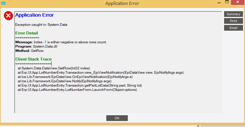

Dear Team,
I’m trying update the record in PartLot db table through receipt entry form. But my record is inserted into table after that i got an issue. Kindly help on this.
I’m trying fix this issue in Convert.ToString() used in every in my code but, i don’t why its coming on this error. Please find the below screen shot for your reference.
Can you post the custom code you’re using? It looks like you’re trying to access a datarow before there is any data loaded in the form. Check your EpiViewNotification handler to make sure you’re checking that the current data row index isn’t -1.

This is the only thing I can imagine would throw an error related to a DataRow, but I don’t think it would be the IndextOutOfBounds exception you got. Try adding a check after the first line to check if edvpartLotRow is null before accessing its members.
@tsmith
I’m getting the same error.
Note: same error in Lot Entry form accessed from Receipt Entry form.
