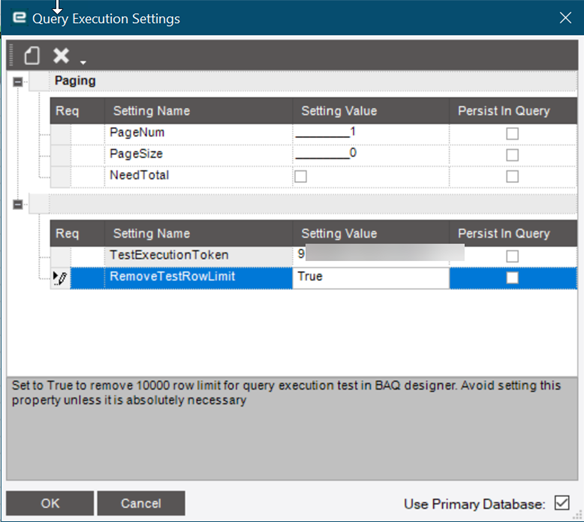

You can remove the test row limit in the BAQ designer. Also if you’re on prem, you can change a setting in the app server but it limits the max returns to that setting.
Actions - Execution Settings:
