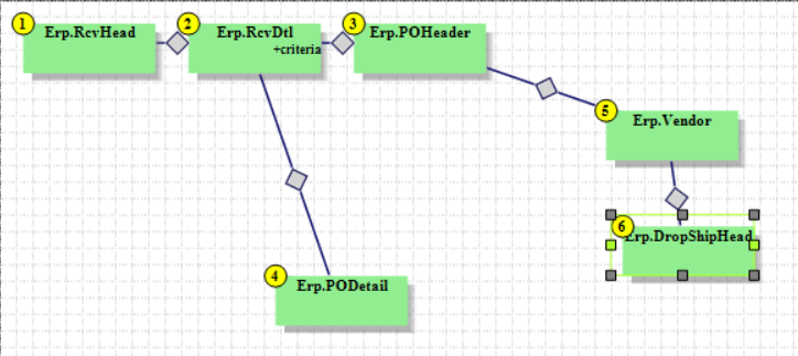

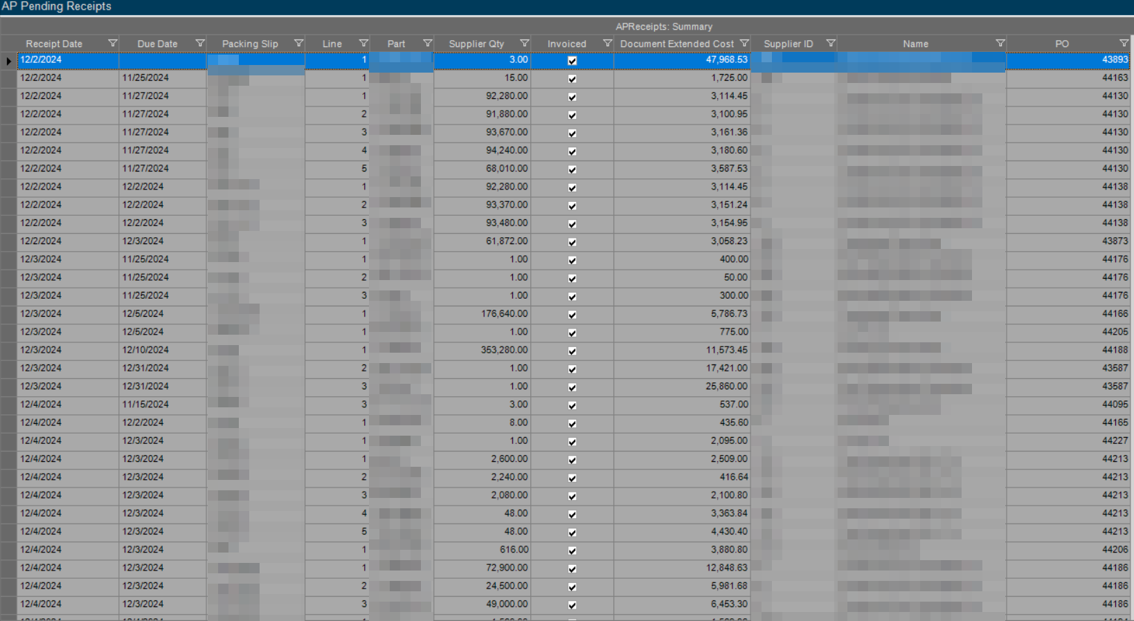

I have an AP receipt that is not showing on an AP receipt dashboard. The receipt is from a drop shipment. I have pulled Drop Ship Head into the BAQ, but am still not seeing the packslip/PO from the drop shipment. What am I missing? Thanks in advance.

To resolve this, you’ll need to create a union query.
  1. Top-Level Query: Start with your standard PO Receipt tables and add a calculated field labeled ‘DocType’ with the value "PORcv".
  2. Union: Combine this with your Drop Ship tables, and include another calculated field labeled ‘DocType’ with the value "DSR" (or any identifier you prefer).
This approach will merge both standard PO receipts and drop shipments, ensuring everything displays correctly on the dashboard.
