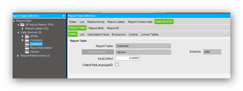

In 10.2.300.15, adding a second instance of a table works (kinda), if you name the second table the name of another existing table (I had to enter the alias name before searching for and selecting the table):
Adding a copy of the Vendor table and naming it Customer:

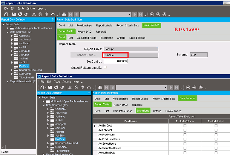

Hmmm… just rtied on a 10.1.600 test system & seems to be working?
May be another one of those things that I “learned” did not work but…was in earlier versions and I may need to do some “unlearning” and test again?

In my case yes… same JobOper reocords from the RDD selection, just aliased.
So wouldn’t help you.
but…now I’m really interested in testing that example of second instance in the RDD.
Pobably will be a couple days before I can get around to it…
Thinking it should work though… assuming there isn’t some underlying logic/joins that short circuit the second instance?
Now I wonder why you’re getting an error when you try adding a second instance to an RDD on your system…if a version bug or possibly your entry sequence?
