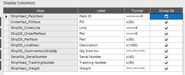

It were added all to a tablix but even if I change in the to “First” all the values show up are SUM when I add the expression.
This is my BAQ

Okay. Leave your BAQ as shown in your screenshot (no Calc fields). It will generate a row for each SN. Then in the SSRS Report Builder, group on PackID, and PartNum. Put a footer in the PartNum group, and have your sum expression in there.
