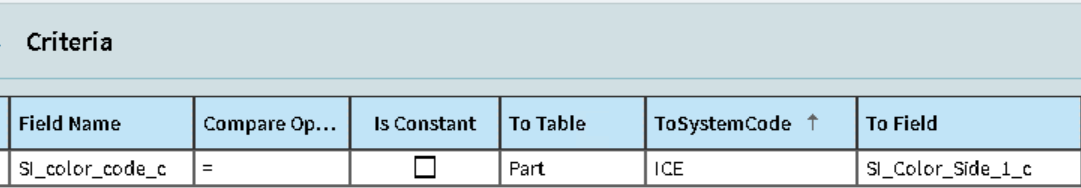

I’m adding the following criteria to the UD03 table in order to specify the records I want returned.
Translation: UD03.SI_color_code_c = Part.SI_Color_Side_1_c

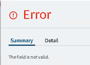

So this equation has UD fields on both sides and generates the following error:
This error appears to be related SOLELY to the right side of the equation. If I change change the Part.SI_Color_Side_1_c to Part.PartNum (and ICE to ERP), there is no error.

Did you include (uncheck Exclude) the fields you want to use in the criteria?
Thanks Hugo. I sure did.
In fact, as i mentioned, if I specify this relationship AS a relationship, no problem!!!
It’s just when I use it in the Table Criteria where I get an error. It seems not to like a UD field to the right of the equal sign.

Regardless of selection (ICE/ERP) I receive an error with a UD field on the right side of the equal sign, However, if I specify Part.PartNum, I MUST select ERP, otherwise I receive an error (the SAME error).

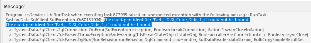

@klincecum, I added the UD03_UD and the Part_UD to the RDD. I established relationships between these by SysRowID = ForeignSysRowID as you outlined. I then selected the UD03 table and created the Table Criteria to limit the returned rows.
No problem with these (Yay!)
Attempting to preview the report, however, reveals the errors. In System Monitor, under History/Logs - unable to bind the UD fields, and no report is produced.
