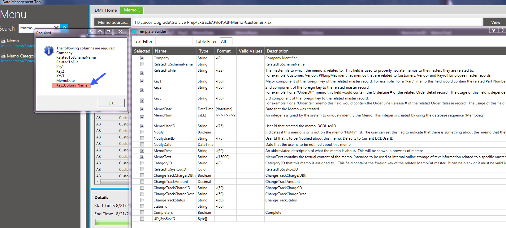

I tried to import Memos related to Customer into E10 with DMT. They key1 field was properly populated in my Excel spreadsheet. But when I import and then examine the table, it looks like they key1 field is something different than what my spreadsheet had in it.
Could I run a delete query in the SQL to remove all those and try again?
What is key1ColumnName and what should an example value be for loading customer numbers? It’s not described in the template.

When I look at required fields for 4.0.30.0 this is what I see.
Company
RelatedToSchemaName
RelatedToFile
Key1
Key2
Key3
MemoDate
RelatedToSysRowID
I think your Key1ColumnName should be “RelatedToSysRowId”

I am getting the following error: “Column ‘RelatedToSysRowID’ does not belong to table Sheet1
Any idea on what that value should be?
Mel
Rommel Malay | I.T. Manager
Hendrick Manufacturing
D: (847) 608-2010
M: (216) 392-8934
http://www.hendrickcorp.com/sites/default/files/hendrick.mfg.jpg
I don’t have a column by that name in my sheet. I would remove it.
That’s odd. It’s required on my end. I actually used the sysid on the customer file and it worked.
