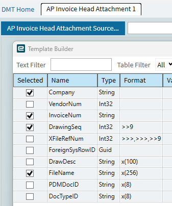

The DMT template for attachments on Invoice Head is quite simple - company, Invoice Num, File Name, Drawing Seq (default to 1). You just have to make sure that the account running the DMT has access to the file location of the attachments.
The relationship you have to establish is filename ↔ InvoiceNum. It doesn’t require Vendornum, but it can, so you can include it if you want to.

One quick note…the vendor ID is required even though the template doesn’t show that. The field name is VendorNumVendorID and the value should be the Vendor ID.
