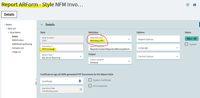

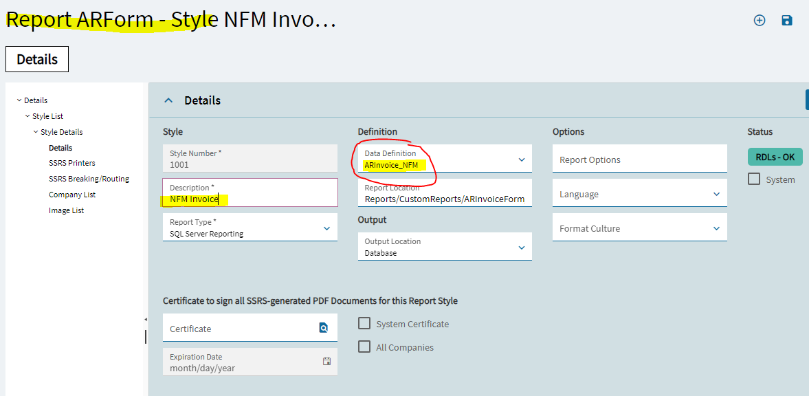

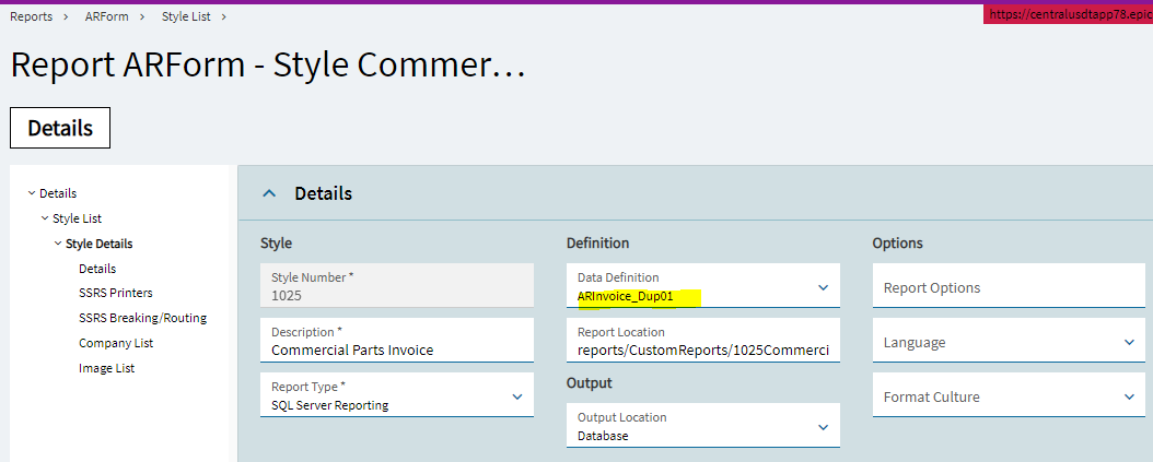

Below is a snip… This is the Report Style Maintenance of ARForm…
I had created a custom style called “NFM Invoice” and I am referencing a custom RDD called “ARInvoice_NFM” (circled in red).
Again, this is only if you’re using a new custom Report Data Definition.

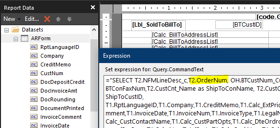

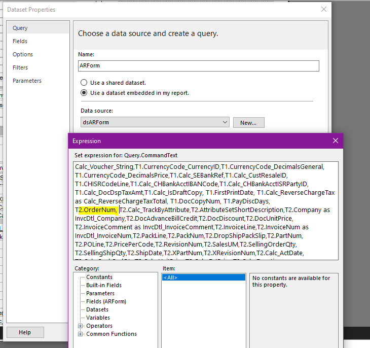

On the SSRS side… make sure T2.OrderNum is included in your query. As you can see below, I have it included in my customized AR Invoice:

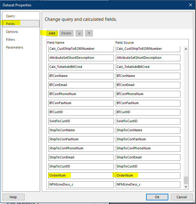

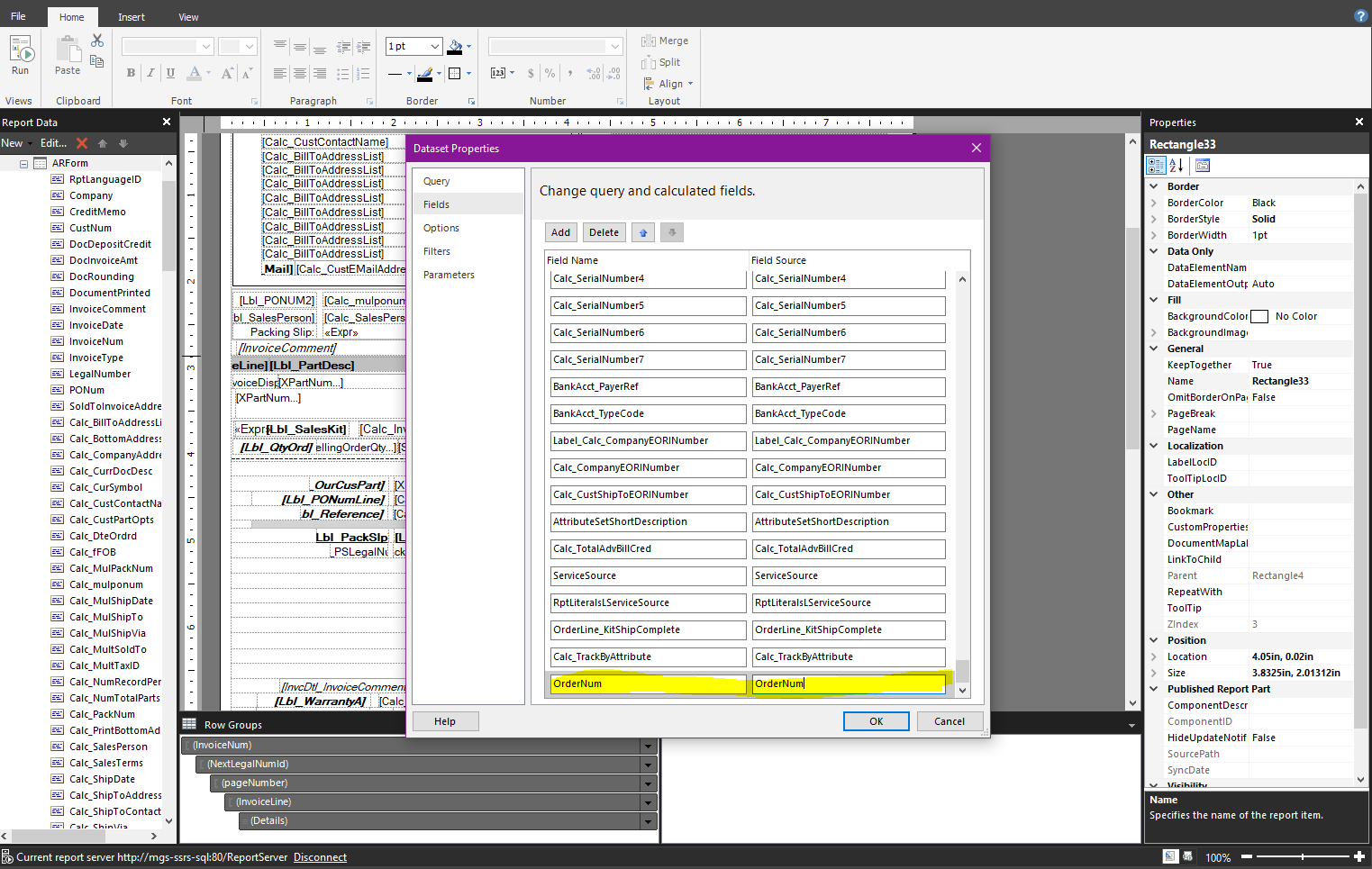

Again, as @jkane mentioned, add the “field” like below (query field, NOT calc field):

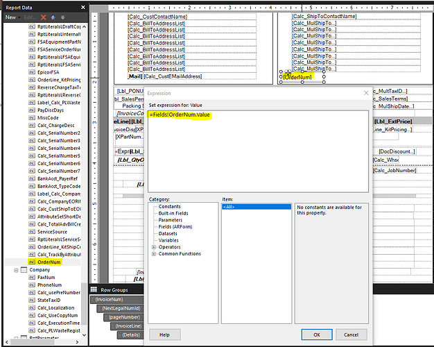

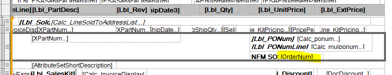

You can then add it to your report:
Expression:

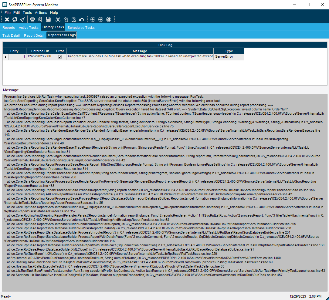

Hello, thank you for this explanation. I am using the out of the box RDD but I did make a copy of the Standard SSRS so I can edit it. Originally I used T1.OrderNum but later found out it was T2.OrderNum
However that still gives an error and the monitor says unexpected error.
can you post a pic of the error details?

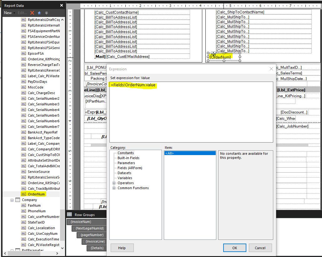

adding field
field planted
in query
monitor error
I see that you are doing this in Pilot. Have you uploaded the report to the Pilot environment? By default, Epicor does not load all of the reports in the Pilot environment. I always had to import them to test in Pilot.

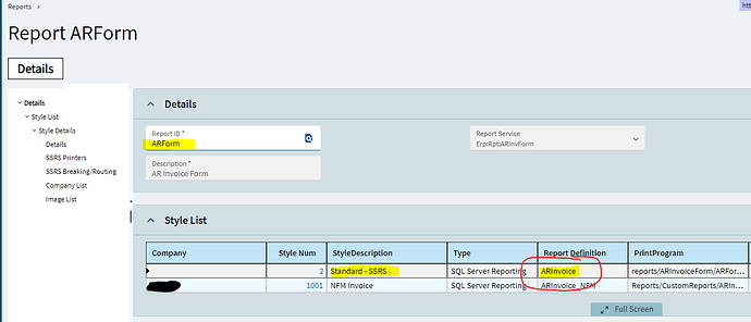

@Creese, can you verify one thing for me… there may be a “gotcha” that we didn’t catch…
Report Style: ARForm (correct)
Report Data Definition:… there are (2) possibilities… do a search… There is ARForm and also one called ARInvoice
I THINK, out of the box, the ARForm (Report Style) calls out the ARInvoice (RDD).
Here’s a screen shot of my report style "details:
Note that the BASE style calls out ARInvoice RDD… and my customized style calls our ARInvoice_NFM

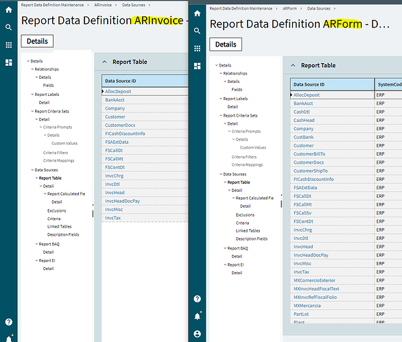

The ARInvoice RDD does NOT include OrderNum!!!

Looking at the RDD I saw OrderNum in CashDtl (this was shown above at 16/30)
Understood… but don’t look at the ARForm (RDD)… its the wrong one.
The ARForm (Report Style) is pointing at the ARInvoice (RDD).
The ARInvoice (RDD) doesn’t “include” OrderNum. It doesn’t even include many of the same tables as the ARForm (RDD):

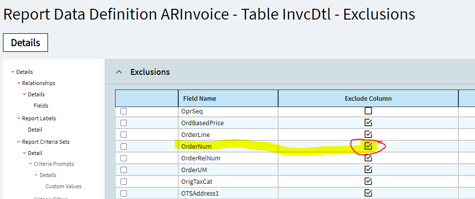

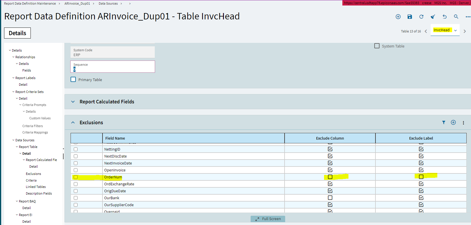

So with the ARInvoice duplicate. go to Detail and InvcHead and uncheck the two boxes Exclude Column and Exclude Label for OrderNum.
Anywhere else I need to do this?
Exclude label doesn’t really matter… but yes, you got it. That should be all you need.

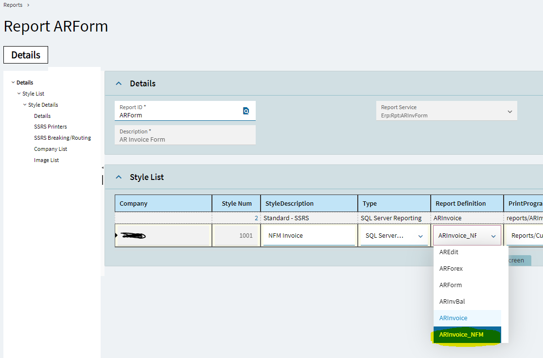

Now, go to Report Style Maintenance… and change the Report Data Definition of your ARForm report to point at your newly created ARInvoice RDD.
Save the Report Style (to make sure it captures the change in RDD) and then test.

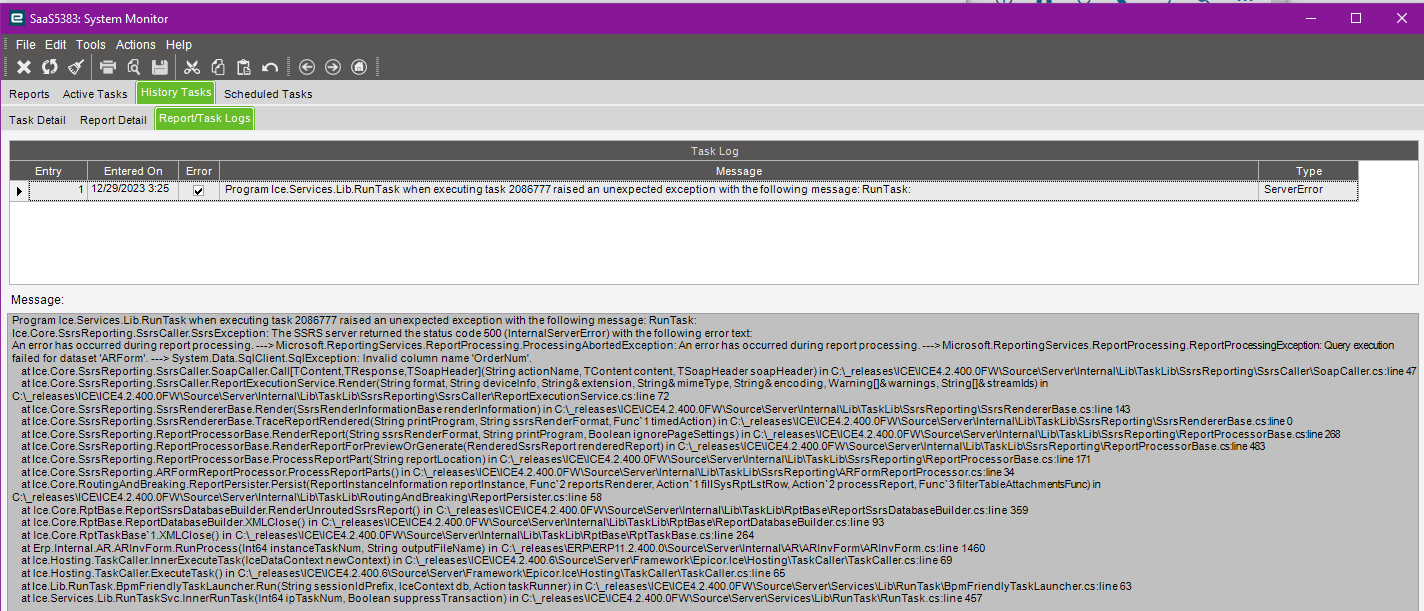

Errors
ReportStyle
RDD
Looks like you unchecked the exclusion on InvcHead table… do it on InvcDtl table.
Sorry, I didn’t catch that in your previous post.
oof, My bad-
I changed that and a number now loads. Whoo!
