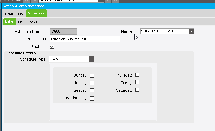

While updating the schedules that run at a specific time of day, (for end of Day Light Saving), by tweaking the Next Run date and time, I noticed the Immediate Run Request schedule has a Next Run setting of about a week out.
First off, is the Immediate Run Request schedule the one used by the Now schedule?
And what should the settings be in System Agent Maintenance? Mine is as shown below.
Daily with no days selected seems odd, and probably why the Next Run value always seems to be a week from the last time it was run.
Wouldn’t the Schedule Type Interval (with a 5 second setting), make more sense?

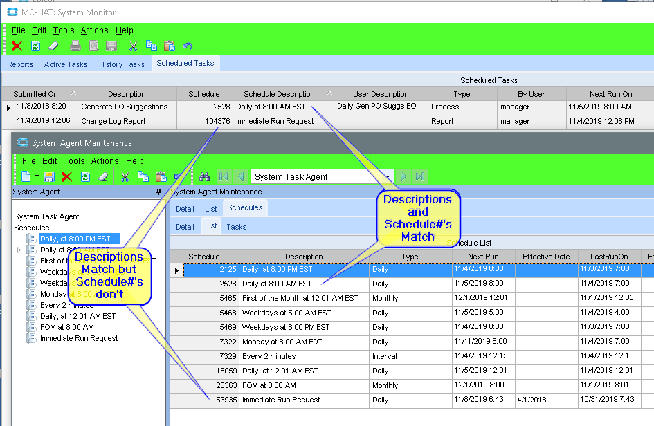

Hmmm … When I run a report with the schedule “Now” selected, I see the following in the System Monitor’s Scheduled Tasks tab:
Note that the upper line (a previously scheduled task) has a Schedule# and Description that match what is in the System Agent.
While the report submitted with schedule Now has a matching description, but the Sched#'s don’t match.
I’ve disabled the “Run Immediate Request”, and the Now scheduled reports still run.
Must have been something I was testing Or though I needed way beck when I first setup E10.
