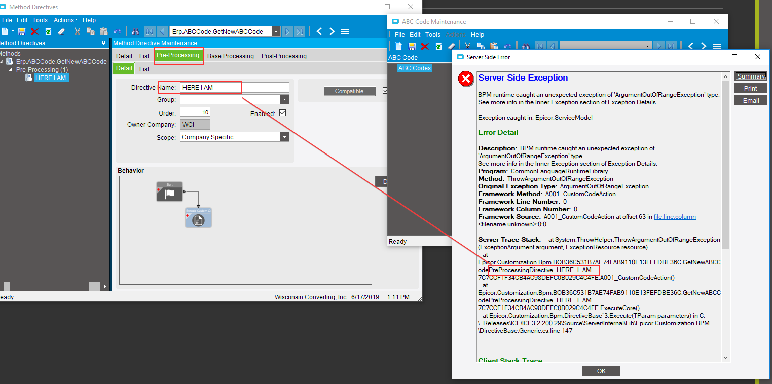

@jgiese.wci I’ve seen that before, but not in this case. The difference might have something to do with the BPM being triggered through the REST API instead of the Epicor UI.

Are you getting that error text from the Event Viewer?

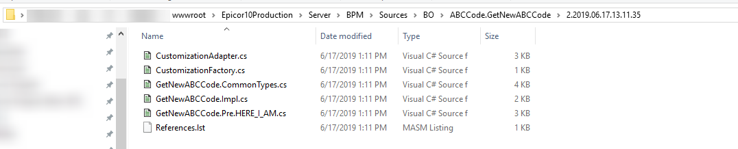

If you want to match that ID to a BPM you can review the BPM source code on your server.
@jgiese.wci Found it. Thanks!
