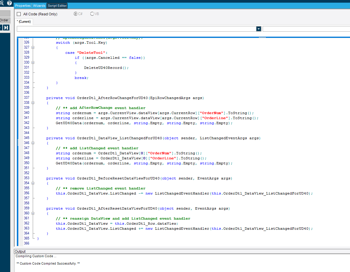

Testing adding the UD Table as a child. Does this wizard actually work? I have added the table and linked a couple fields, the code gets generated. I have yet to compile it as the errors are endless.
I was able to do it without much hassle. You are on the order entry screen?
edit
I tried it and it worked just fine. Added Key1 and Key2 as OrderNum and OrderLine. It finished, now compile errors. What are some of the errors that you are seeing?
We are on different versions though, so maybe there has been some work done on it.
Yes, Order Entry screen and OrderNum and OrderLine fields added.
from the EUG website
Okay, so a search of Epicare’s sup[port KB revealed KB0030682 which basically says that in order to actually do this you have to match up the first 4 UD Key fields with something, otherwise there is nothing to return with a vague reference to possibly handling missing keys better in the future.
To fix it, he just used duplicate values for the keys he didn’t need. (so make both Key3 and Key4 orderline or something)
Obviously it’s been fixed in future versions. That user was on 10.2.100
And his would compile and was on a different screen, so it may not be the same problem.
I added Company, OrderNum, OrderLine and PartNum to use up all four fields. Still won’t compile.
Can you paste the list of errors in here? And did you start with a blank customization? (had to ask)
