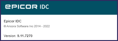

  • Are you using Epicor IDC from Ancora? I see Ancora explicitly referenced at the bottom of my IDC login page (before logging in) and in the Help > About Epicor IDC menu (after logging in).

  1. Yes, we are using Epicor IDC from Ancora.

We are also Ancora, manual (training/fixing in IDC UI), processing through to ECM and work-flowing from there.
