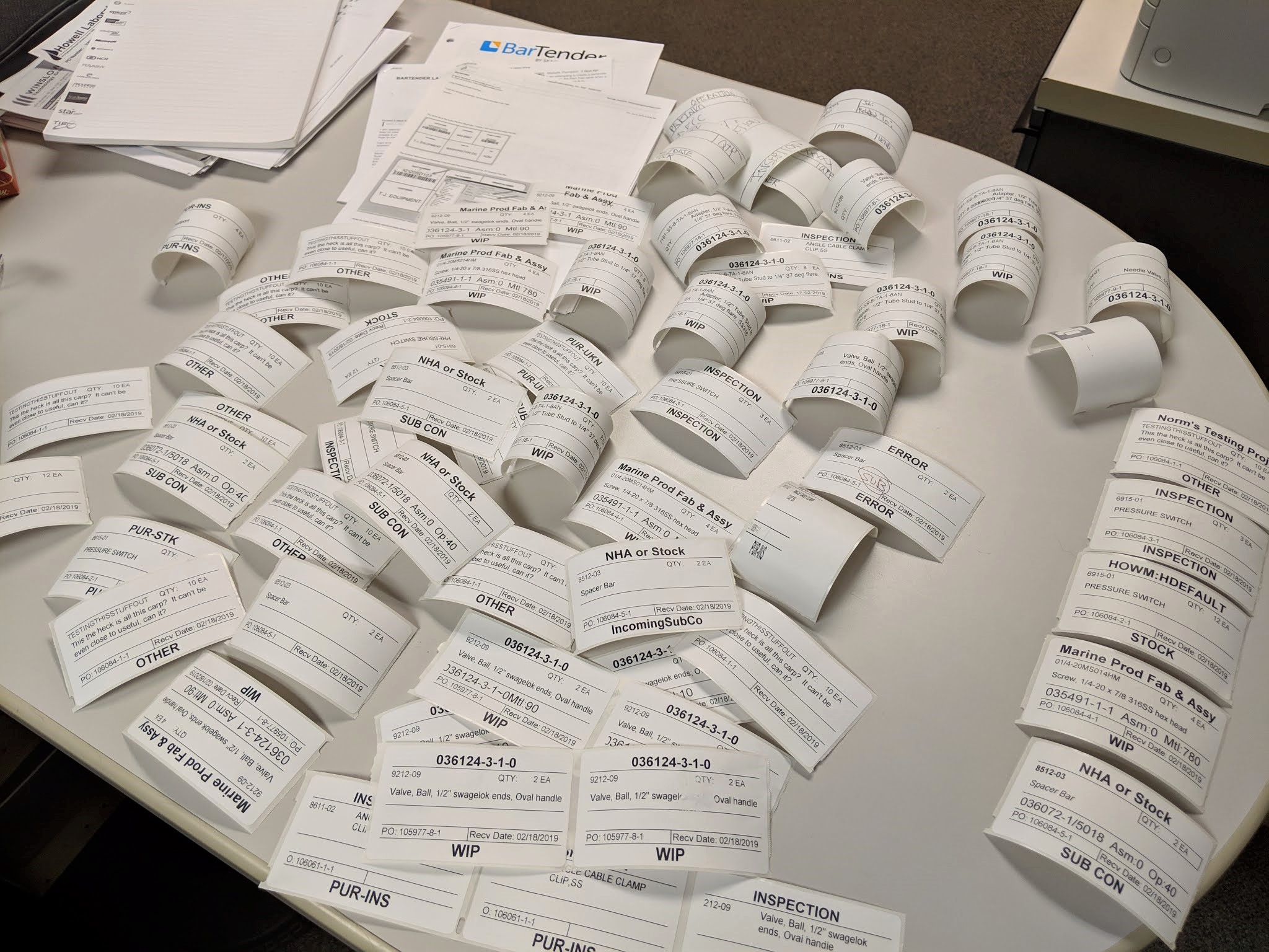

With some pointers from epiUser.Help and @amurdock, I managed to get Bartender installed, setup and semi-functional. Still a work in progress, but happy with the status thus far.
I’ve managed to get correct labels, depending on PurchaseType, to print automatically when a receipt line is marked as received. Still, need to figure out a few things before implementing this is production, but it’s a start!

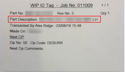

We done this and utilised MTL Tags Report.

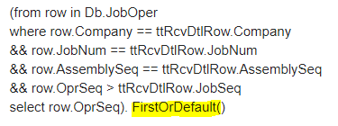

I use a setter in the BPM work flow to find the next op number for example:
(from row in Db.JobOper
where row.Company == ttRcvDtlRow.Company
&& row.JobNum == ttRcvDtlRow.JobNum
&& row.AssemblySeq == ttRcvDtlRow.AssemblySeq
&& row.OprSeq > ttRcvDtlRow.JobSeq
select row.OprSeq). FirstOrDefault()
Then push that into the report parameters.
I’m sure we modified the data definition here also to bind the MtlTags To Job Oper so we could extract the next operations op comments.

your code will give you the first record found, not necessarily the Next operation in sequence.
Hi Al,
Indeed it will but the row above filters out all preceding operations prior to the current op being receipted in :wink: row.OprSeq > ttRcvDtlRow.JobSeq
i can see that, and that is why the code will call any operation from the rest, unless your routing has only one record after the tt current operation which is not always the case
Indeed you are right but the FirstOfDefault statement after this selects the first Record returned.
