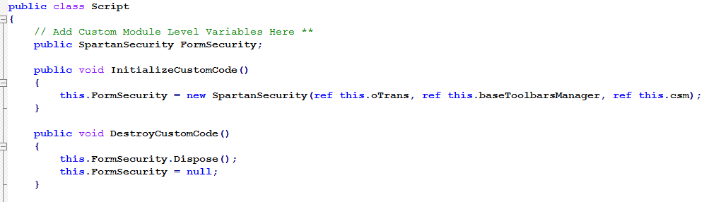

What I tend to do is create a class outside of class Script { } and make use of that for the time being; for code that is duplicated alot.
I also pass through references to objects that I am going to use very likely.
Nice @hkeric.wci
Perhaps some silly questions, but how do you get you get your code outside of the script? Are you able to reference this from any customization?
It looks like you literally just moved your code outside of the script brackets. If you can’t access this from other customizations, what benefits do you gain from doing so? #ThirstyForKnowledge
You cant call it from another Customization; but the benefit for me is that I do not clutter my repetitive code within that Customizations Code; Since it is very likely that Customization B will utilize the same code that Customization A uses; on top of that it will have Unique Code related to only itself… So just decluttering it. Then when I copy/paste it and if I make a change to the class I can easily do a find/replace without messing with the code inside Class Script { } which again might be unique for Customization B or C or D.
