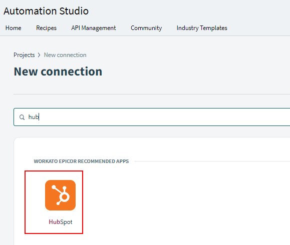

Well I just looked an Automation Studio has a HubSpot integration. Might be worth a look No Code needed (mostly)
Whoa - That Hubspot Workato integration did not exist in September. Holy cow, that could be huge.
