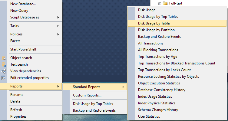

I would recommend getting an idea of where space is being consumed before attempting anything specific.
In SQL Server Management Studio (SSMS), right-click on your Database > Reports > Standard Reports > Disk Usage by Table.
What are the top ~20 tables listed in the report?
