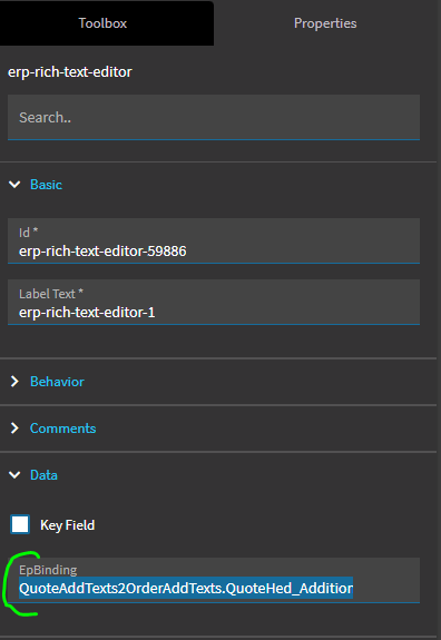

I tried to let both graphical additional text boxes point to the same datasource field, but that did not work (maybe because the connection is missing to link a certain Quote to an Order)?

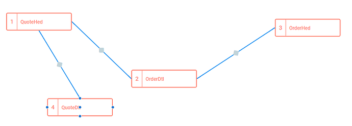

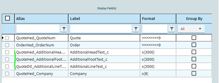

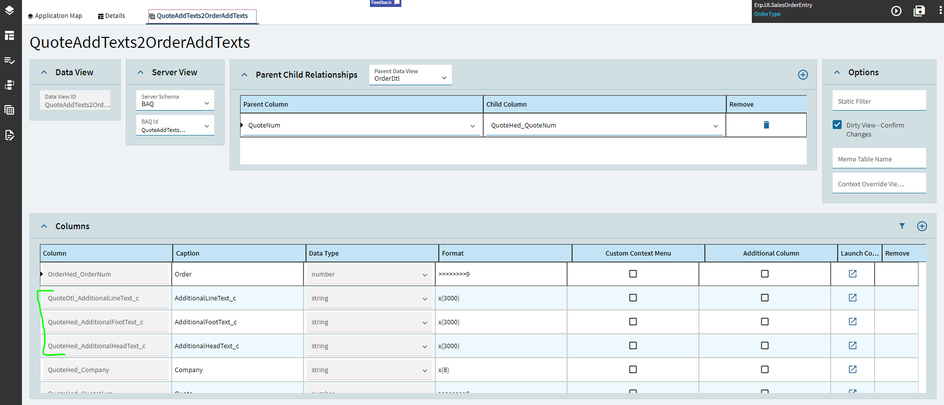

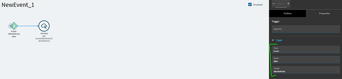

Than I tried to use a BAQ to connect Quote to Order via OrderDtl and pull the Info from the additional text field in Quote to feed it into Order.
