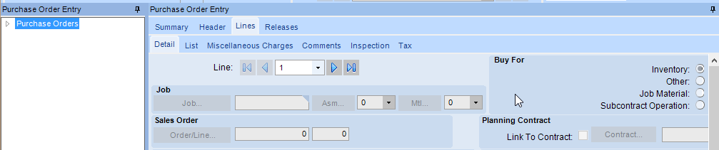

Actually I want to change between detail item like the following image:
We can switch between line item.
Ah, got it. Just bind it to the key field and it should work. What issue are you running into?
FYI, I have custom form with UD06 as header and UD07 as detail. In UD07 tab I have added ultracomboplus. This control is used to switch between UD07 detail based on UD06.
I don’t know how to use this control as I said before I couldn’t find any information of this control. So, it would be great if there is example how to use this control. Maybe snippet code can help me to get some insight of this control.
