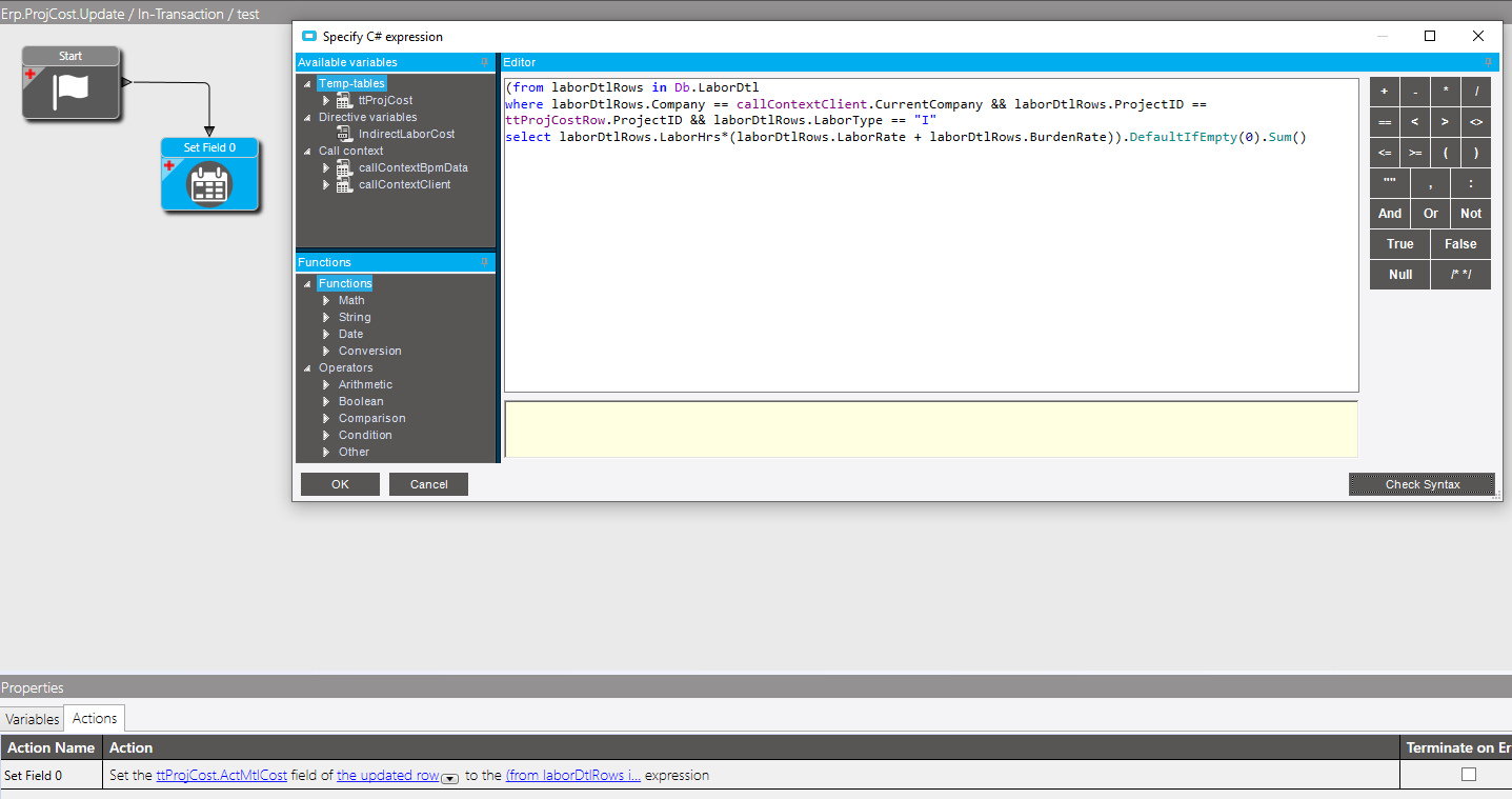

LINQ may be another option then. It’s pretty similar to SQL, and can be used in a Set Argument / Variable widget. You could set up 5 LINQ statements for each UD field to use in a set-field widget. Here’s a statement I previously used for labor quantity sums. I changed it to calculate indirect labor costs:
(from laborDtlRows in Db.LaborDtl
where laborDtlRows.Company == callContextClient.CurrentCompany && laborDtlRows.ProjectID == ttProjCostRow.ProjectID && laborDtlRows.LaborType == "I"
select laborDtlRows.LaborHrs*(laborDtlRows.LaborRate + laborDtlRows.BurdenRate)).DefaultIfEmpty(0).Sum()
I haven’t tested it, we don’t really use the projects functionality here. But you could give it a shot, the syntax is OK. For the production and setup costs, you could do the same thing but change the laborType from I to S/P. A similar statement could be used for the material costs.

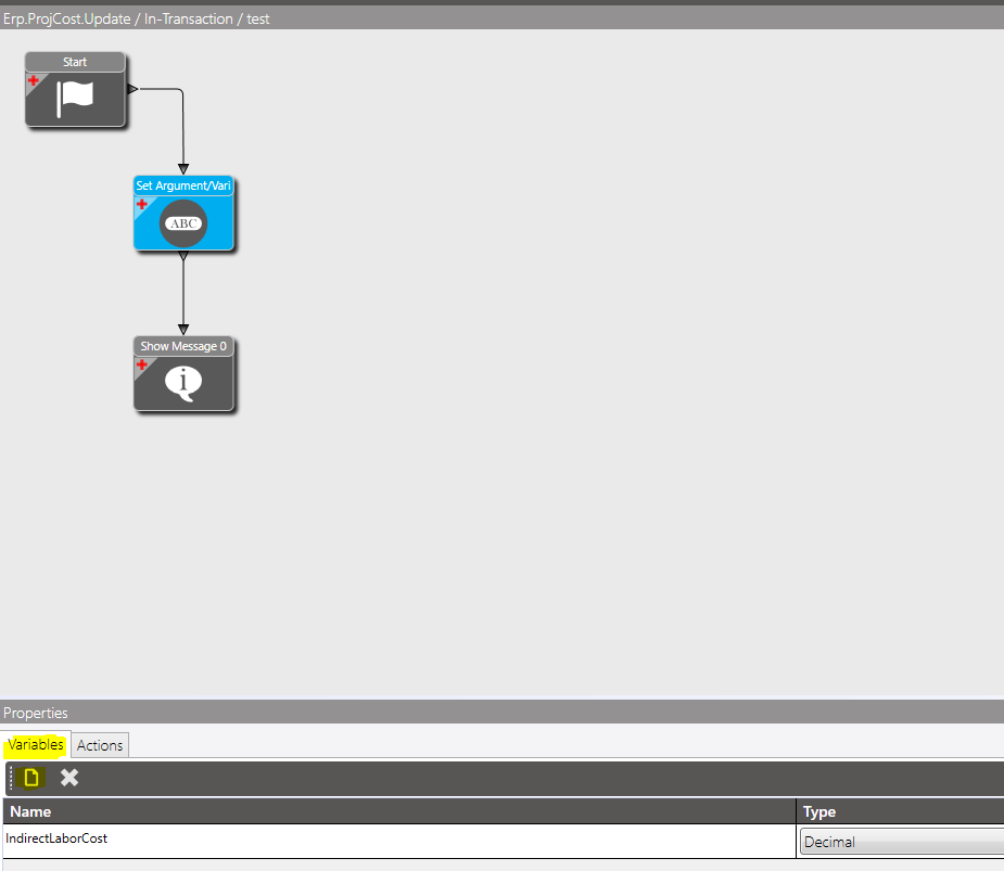

How did you declare your variable? I just took what you had and pasted into the Editor and it doesn’t work. But, I don’t have the ‘IndirectLabor’ variable that you do. I missed a step somewhere.

Sorry for the confusion, I didn’t actually use that IndirectLaborCost variable in the screen shot. I just directly set a field (didn’t have your UD fields) to the LINQ result in that “set field” widget. You could also use the LINQ statement to set a variable (that you create).
This is in an in-trans data directive on the ProjCost table. I didn’t see the “ProjectCst” table until I looked a second time. Here’s how the LINQ statement would change for that table:
where laborDtlRows.Company == callContextClient.CurrentCompany && laborDtlRows.ProjectID == ttProjectCstRow.ProjectID && laborDtlRows.LaborType == "I"
