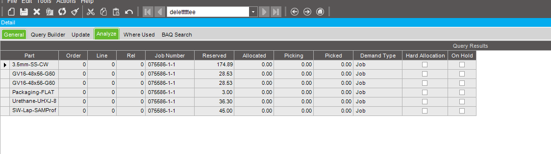

Any allocations on the JobMtl?
Yeah, I can see the material is reserved, but I can’t find any way to unreserve it.
The Job -> Reserve / Unreserve material window is always empty.

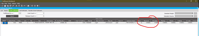

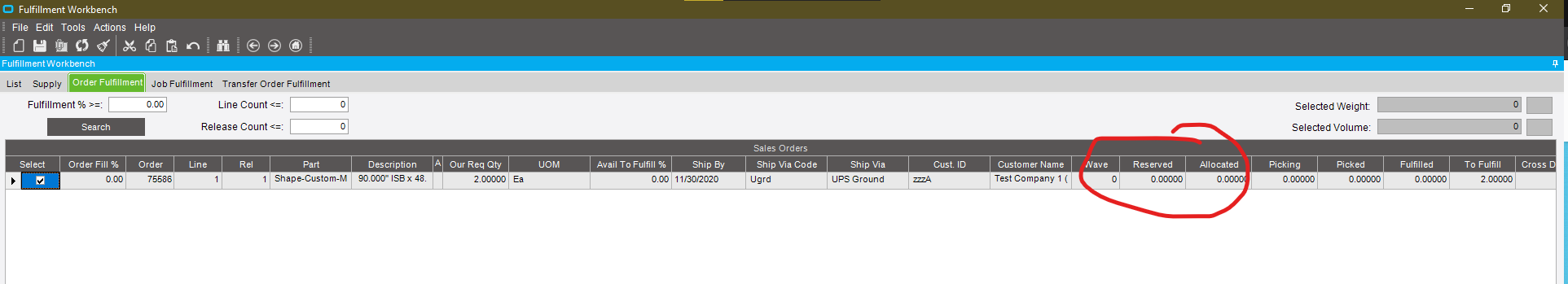

Can you not “Unallocate and Unreserve” from the Fulfillment workbench?
Also, if you have AMM, it sounds like your “Reserve Inventory on Job Release” setting in site configuration is set. Do you want the stock reserved automatically?
Huh, I had tried that before and no materials were appearing, but I went through the steps again slowly and carefully and I got it to work this time. Maybe unchecking released and Engineered made the job not show up in the fulfillment workbench correctly.
