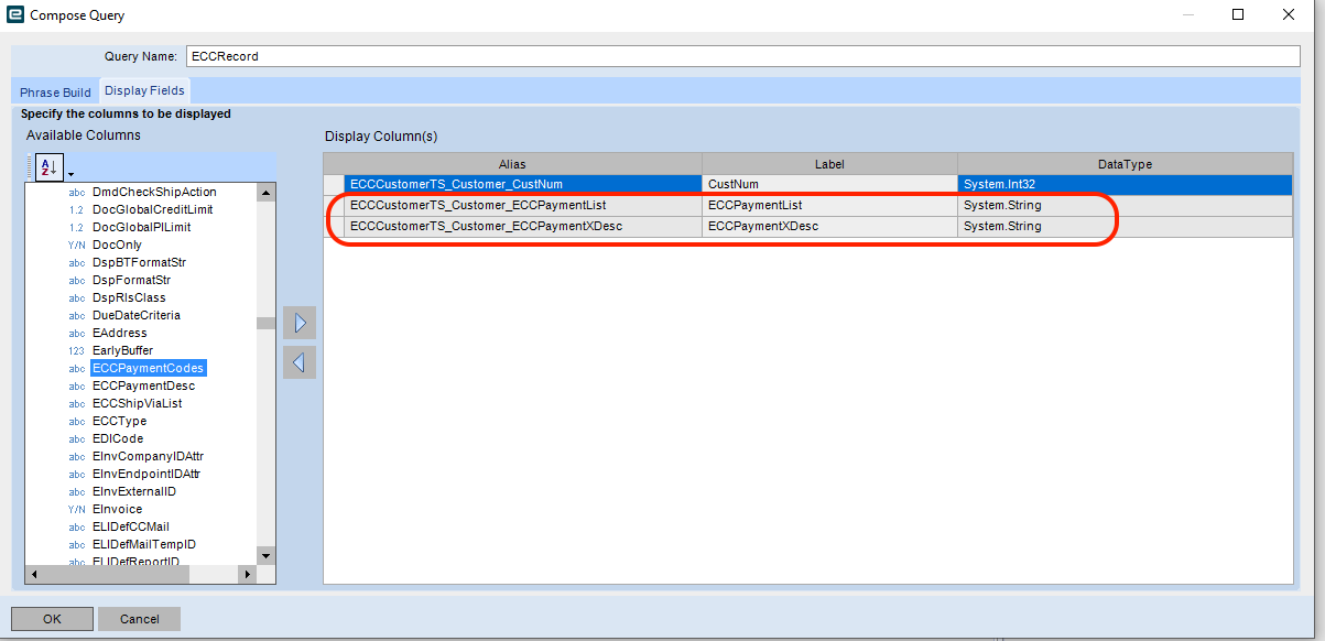

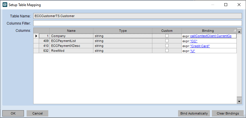

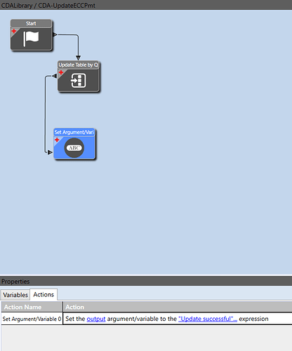

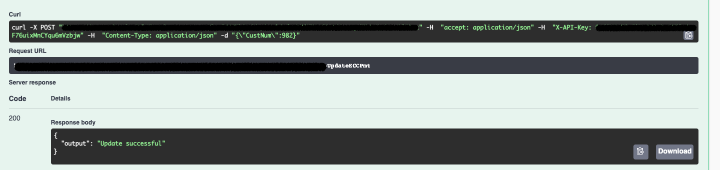

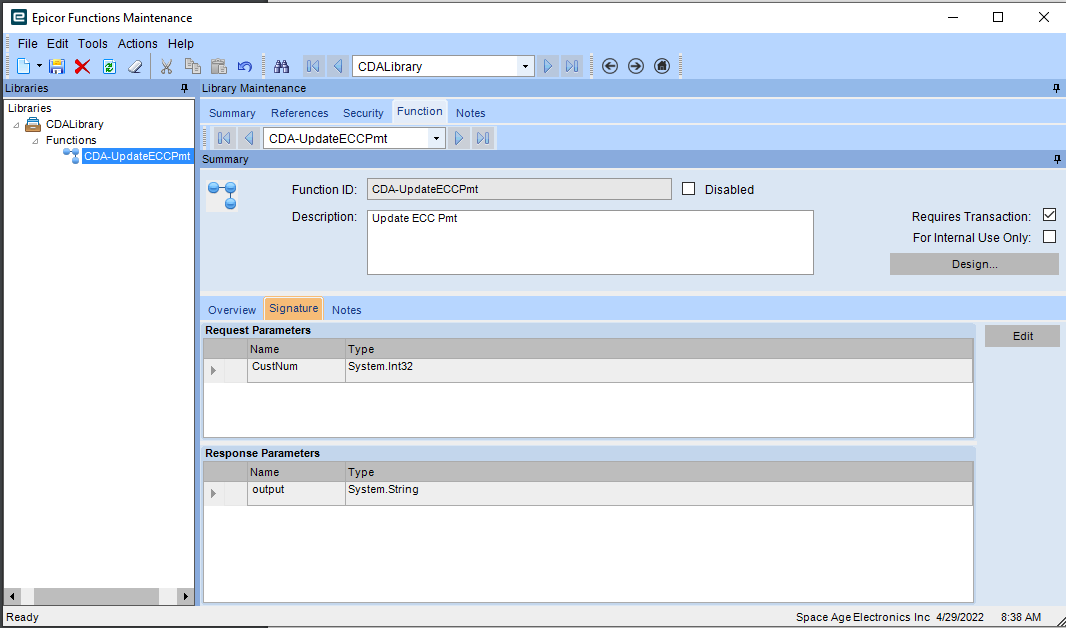

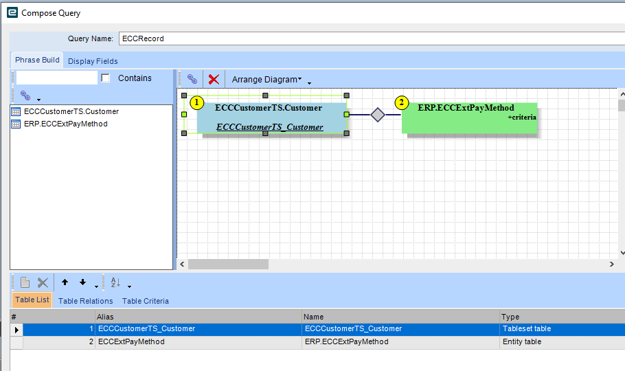

I also tried creating a function that I call from the BPM, passing in the CustNum to be updated from the BPM then building out an ECCExtensionCustomerTableset (which does give access to the fields I need), but I can’t seem to get that to work either. I get a Success message but the table data never updates. Here’s how I have it configured:

I’m curious if there’s any way for me to know if the transaction is successful. I know in raw SQL I can use a TRY/CATCH block and output any errors, but I don’t know if it’s possible with a widget?
Can’t say I use the widgets too often but if you use custom code to update the record you can add try catches and display a message if an error is encountered
