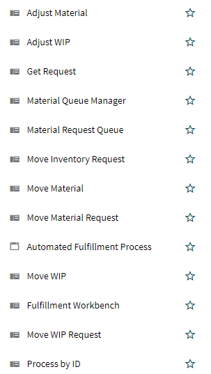

That module allows you to track inventory in WIP. If the shipping warehouse has locations, add a packaging operation at the end of each job and have someone put away the finished product in a location.
Yes, I see what you mean. Once it’s packed in a location, is it possible to perform inventory move in WIP?
Perfect! Thank you so much for your help!
Just be aware, you can’t move finished goods in WIP once they are at the assembly level… yet.
