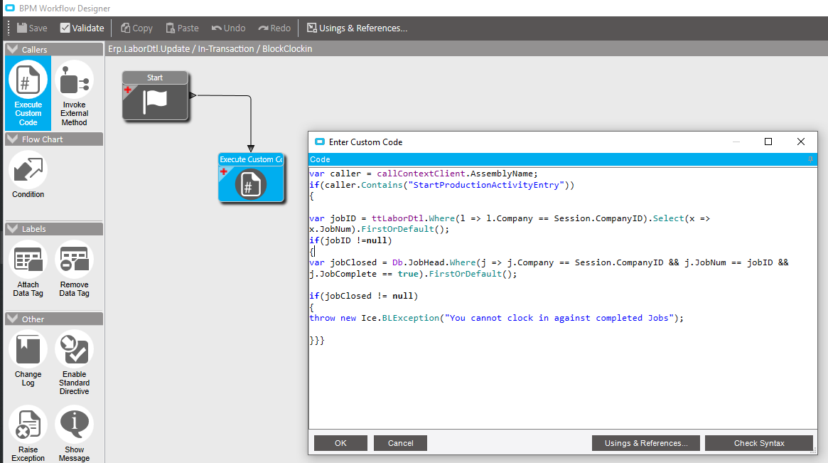

if you are using MES, you can create a BPM that looks at Labor.Update to find when someone is STARTING an operation… the BPM can look to see if the operation is already marked as Complete… and if it is, then disallow them from clocking in.

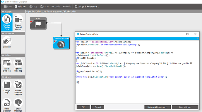

I use this to stop people clocking in against completed Jobs on MES, you could modify it to suit your needs
It’s on a Data Directive
var caller = callContextClient.AssemblyName;
if(caller.Contains("StartProductionActivityEntry"))
var jobID = ttLaborDtl.Where(l => l.Company == Session.CompanyID).Select(x => x.JobNum).FirstOrDefault();
if(jobID !=null)
var jobClosed = Db.JobHead.Where(j => j.Company == Session.CompanyID && j.JobNum == jobID && j.JobComplete == true).FirstOrDefault();
if(jobClosed != null)
throw new Ice.BLException("You cannot clock in against completed Jobs");

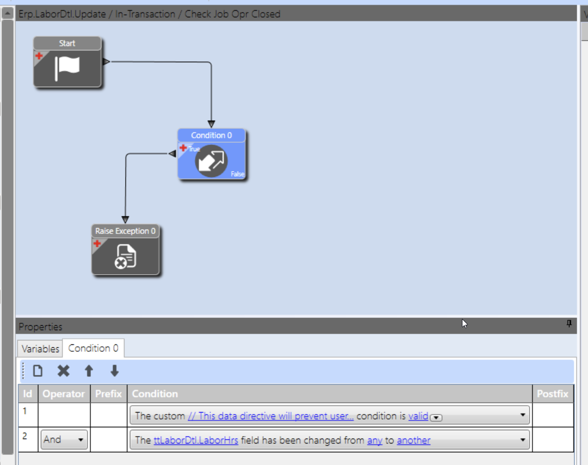

We have just found the same issue. Our solution was to create a data directive on Labordtl table that prevents updates if the job operation is closed. Note: we had to make sure the BPM only fired if the laborHrs feild was changing as the Build Project Analysis process (and probably other processes) upodate the labordtl records also.
I can post details if people want.
Brett
If you can share, this would be most helpful.
Sure.
This is the BPM, its an intransaction Data Directive on the LaborDtl table.
The condition widget has the second condition line so that the BPM only fires when the LaborHrs field changes. We found that some processes would make changes to other fields so this makes sure the BPM only fires when the laborHrs has changed.
Here is the code for the custom code condition. We have a specific scenario that we need to allow people to create time entry lines with zero hours when the job operation is closed.
foreach(var l in ttLaborDtl)
  var job = l.JobNum;
  var OprSeq= l.OprSeq;
  var AsmSeq = l.AssemblySeq;
  if (job != string.Empty)
     var opDetails = Db.JobOper.FirstOrDefault(op=> op.JobNum == job && op.AssemblySeq == AsmSeq && op.OprSeq == OprSeq);
     if (opDetails.OpComplete && l.LaborHrs > 0)  // throw error if the operation is complete and the labour hours are greater than zero.
       return true;
return false;
Cheers
Brett
