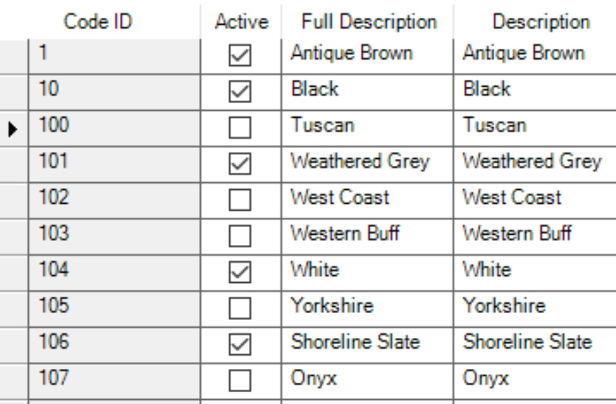

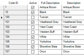

We have a UDField for “Color”. Over the past 5+ years we’ve added many color UDCodes to this list. The drop down list is no longer displayed alphabetically (or numerical in other UDFields cases). How can we “re-sort” the UDFields so the drop down list displays A-Z or 1-9?
Edit: UDField drop down list is in the order of the CodeID. Can Epicor sort the drop down list based on the “Full Description” or “Description”?

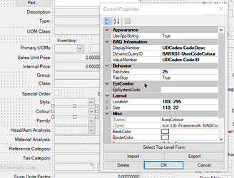

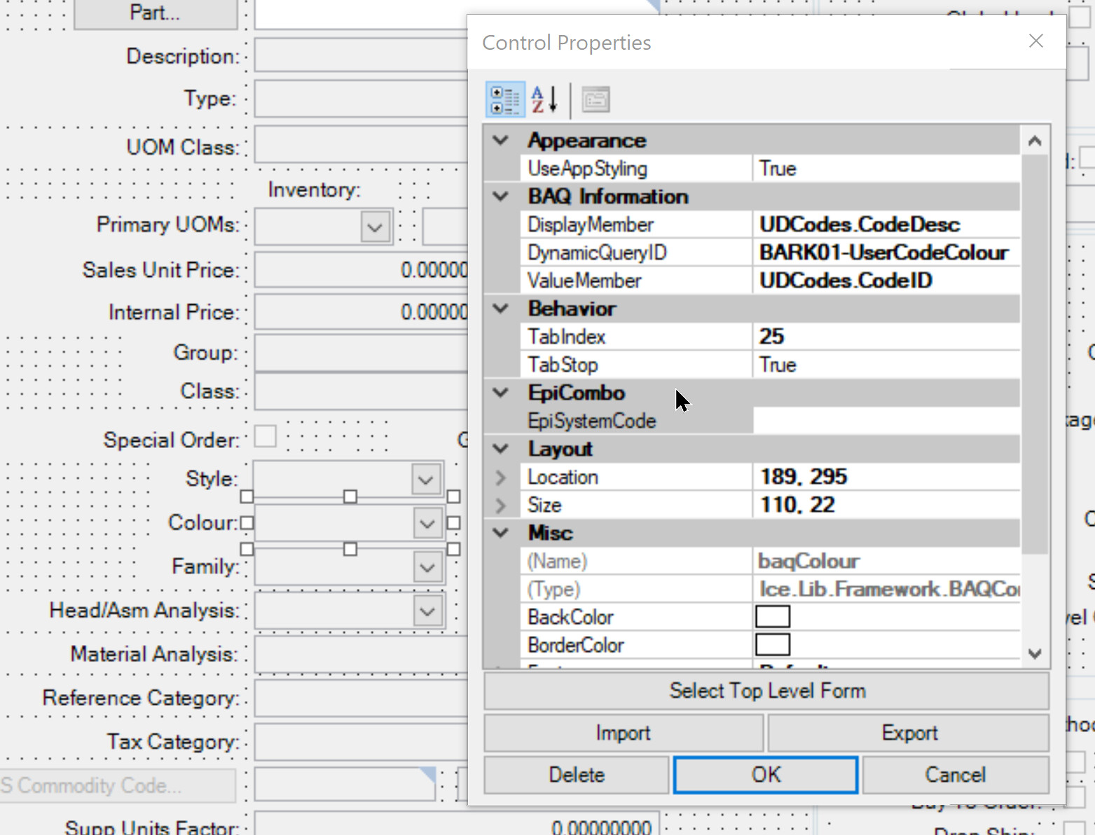

Is that in the “Personalization” screen? I see EpiCombo but not able to do anything.
It looks like you’re using a BAQCombo box instead of a EpiCombo. In which case, I guess you could go into whatever BAQ the powers the box and set the sort order there?
Thanks! They were BAQ’s, just had to add a Sort Order!
