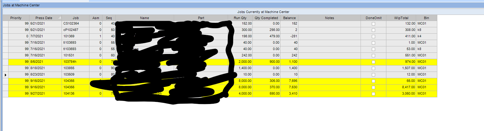

Here is a print screen to explain better. All of these jobs are ready to go into the machine center. The ones in yellow have active labor transactions on them. I want to show the employee’s name that has the active transaction and still be able to see the work que.
@hvrabbit join labordtl to your base table on jobnum,asmemblyseq and oprseq with join type of all rows from the base table. Then join LaborDtl to EmpBasic on LaborDtl.EmployeeNum = EmpBasic.EmpID for the Name field. This is also a join type of show all rows from LaborDtl.
This could make the operation shows multiple times if there are more then one active operator. In that case you would need to make the labordtl part a subquery to get a list of the active operators into one field if you only wanted the operation once.
That did it! Thanks! :pray:
