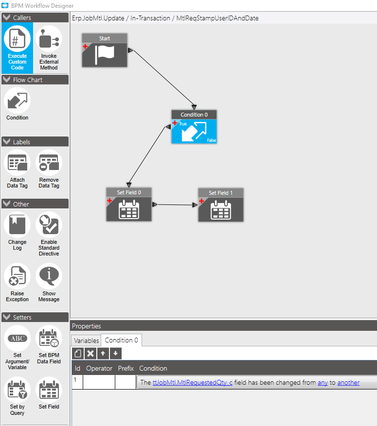

Hi,
as Mark suggested,Post Process Method BPM to save the system user, and DateTime in UD fields, i have done something similar on JobMtl Table but based on a UD check box i created.
