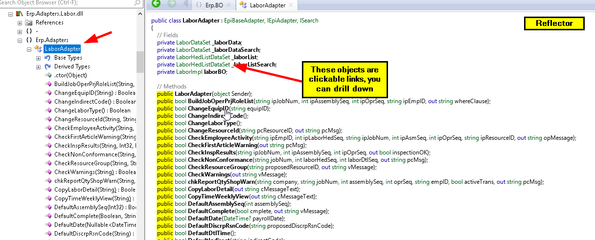

@embedded There are several decompilers available that are all very similar, here are the main ones:
ILSPy - free, awesome
JetBrains DotPeek - free, not my favorite
RedGate .NET Reflector - paid, not too shabby
You should start with the guides and references - they set up the concepts and patters mostly used
Tracing and BL Tester - are great for the next step, since you need to know what your looking for
Decompile - your last step to get the finer details about whats happening under the hood
A few tips:
An adapter is just a fancy wrapper for a BO/Contract
When decompiling - start by focusing on public methods/objects - sure the invisible private ones are helpful for better understanding, but for your purposes, public is where it is at.
It will take some time before you start understanding the namespaces all of your classes are organized in, but once you do, it’s much easier to hunt stuff down
More specific to your question, you can drill down as mentioned below to look at the DataSets, this will show you all of the tables in a DataSet (in my picture - LaborDataSet), in my picture, I drilled down even further into the LaborDtlRow definition to see the fields (and types) avialable
@chris_conn sorry not sure if I should start a new thread… Thanks for the pointers, I have ILSpy installed and it looks like I needed to open the dll file with the AD in the name for the adapter (I first opened the BO but your screenshot was helpful to see it was the wrong dll). I’m slowly making my way around by starting with working code then looking to see how I could have figured this out on my own with the decompiler. As an example I started with a working line of code - adapterSalesOrder.SalesOrderData.OrderDtl.Rows.Count. I found SalesOrderData is a SalesOrderDataset instance, and in looking in the implementation I think I found OrderDtl is an OrderDtlDataTable, but I’m having a hard time finding Rows… Anyway, I’ve been using the SOAP APIs for a couple of years and I have similar challenges where I have datasets that I don’t understand ahead of time so I typically use print_r(serialize / stringify an object) in PHP to look at what is returned to me and for the most part the data structure is pretty intuitive and I can figure out what I’m looking for. I’m fairly new to C# and right now wishing I could just run print_r(adapterSalesOrder.SalesOrderData), so I can see what the data structure looks like. Is there a way to do this in C# as a quick and dirty debug tool?
