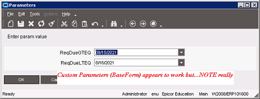

I found it was possible to customize the parameter form but…
I couldn’t find any way get the system to actually use the custom version.
e.g. I used the same customization name for to the MainController and BaseForm
and specified that in menu maintenance (which works for most subforms).
e.g.
The custom code below on the BaseForm but it only works in dev mode where I can manually pick my customization…
private void BaseForm_Load(object sender, EventArgs args)
// Add Event Handler Code
DateTime dt1 = DateTime.Now;
TimeSpan thirtydays = new TimeSpan(30, 0, 0, 0);
DateTime plus30 = dt1 + thirtydays;
edvMain.dataView[edvMain.Row][“ReqDueLTEQ”] = dt1;
edvMain.dataView[edvMain.Row][“ReqDueGTEQ”] = plus30;
