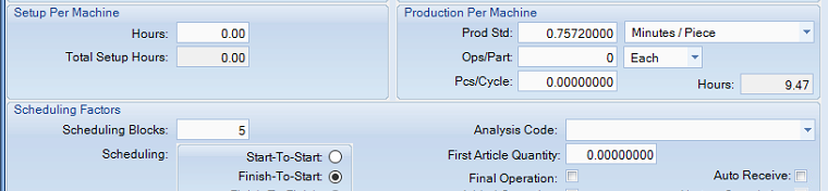

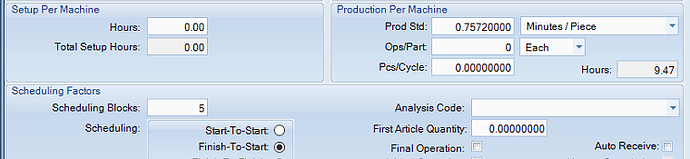

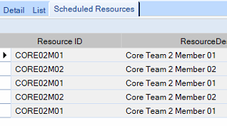

Everything is an integer in the MRP calculation so if you have an 8 hour calendar and a 50 hour job that is 6.25 machines, so you will need to assign 7 scheduling blocks to the operation BEFORE it is scheduled and Epicor will handle the rest. The resources can be used multiple times in infinite, so Epicor may assign it seven times or like my example 1 and 2 are used.
I do ours in JobEntry.Update and it based on the hours of the job under 40 gets 2 resources, 80 gets 3 resources, 100 5 resources, etc, but you will have to trace out how MRP is making the job and possibly update them in a JobOper data directive.

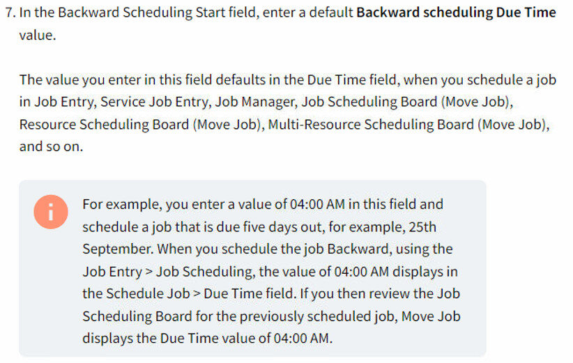

What is the site backwards schedule due time? If that is 4:59 PM and the jobs are just a few hours and you are infinite it should give you all one day jobs.
The more scheduling blocks you add it applies what Epicor calls the squeeze factor to finish the job sooner. It is not a real person or resource, just to make the math work.
In Site Maint.
Unfortunately this resource is finite, jobs cannot run concurrently. Backward scheduling Start is set to 23:59. Changing to infinite and adjusting backward start time to 4:59pm indeed completes all jobs in the same day but this wouldn’t work for us.
