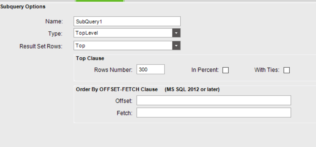

on the subquery tab, you can tell the BAQ to only return the TOP 1 records.
Have it setup like this:

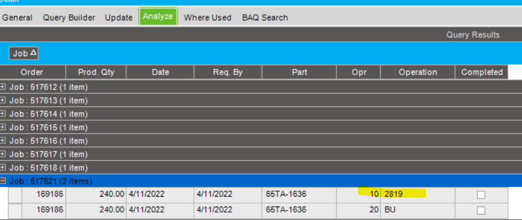

But need only he first operation not completed to be showing up. Below is where it is showing the two rows
If I take the 300 rows and make it 1, only one row shows up for the entire BAQ.
I assume that your operations are pulled from a subquery. If that’s the case, then make a calculated field to return the minimum oprseq number from your list of incomplete ops.
