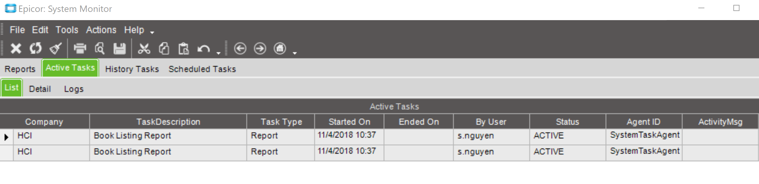

How can one remove/delete an active task or scheduled task shown in System Monitor? Thanks.

Our version is 10.1.500. I am a security manager and tried to remove the tasks but I could not.
Can user “s.nguyen” delete it?
Just curious if you can’t delete because you didn’t initiate it, or if it can’t be stopped at all (even by the orignator)
s.nguyen can not delete it either.

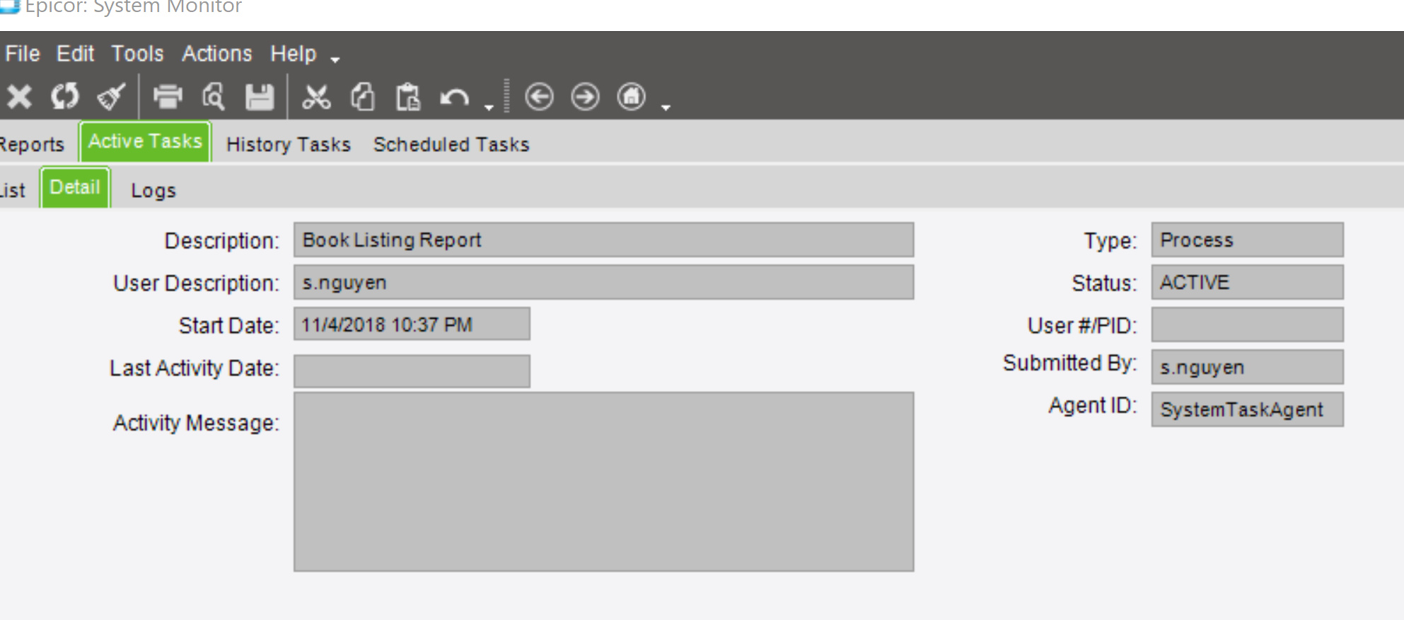

What shows under the Detail or Log tab for those processes?
nothing under Logs
