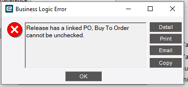

Hi Terry, Pls change Order Release from BTO to BTS(buy for stock), you can close BTO order release, add new order release which don’t tick Buy To Order.
Can’t uncheck BTO. +(

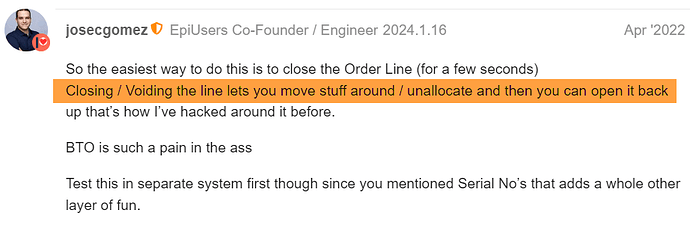

It looks like this is an issue without a good fix. 2nd link below has a lot of undoing.
Terry,
Thanks for your reply!
from second post, close order release and order line, then you can unallocated BTO stock quantity.
