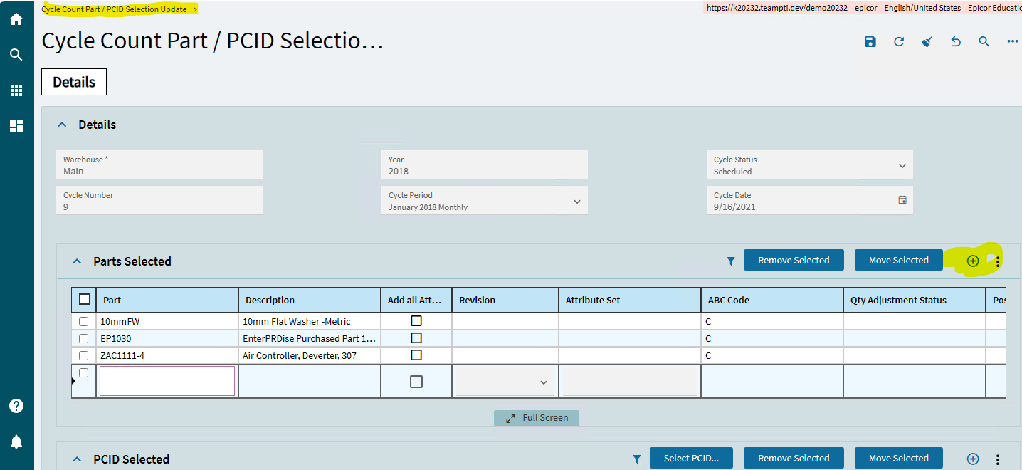

In the browser:

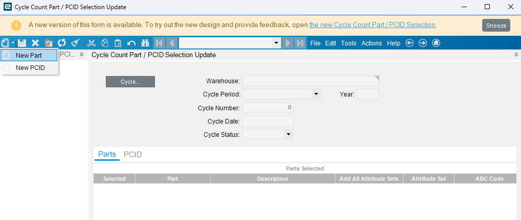

Smart Client:

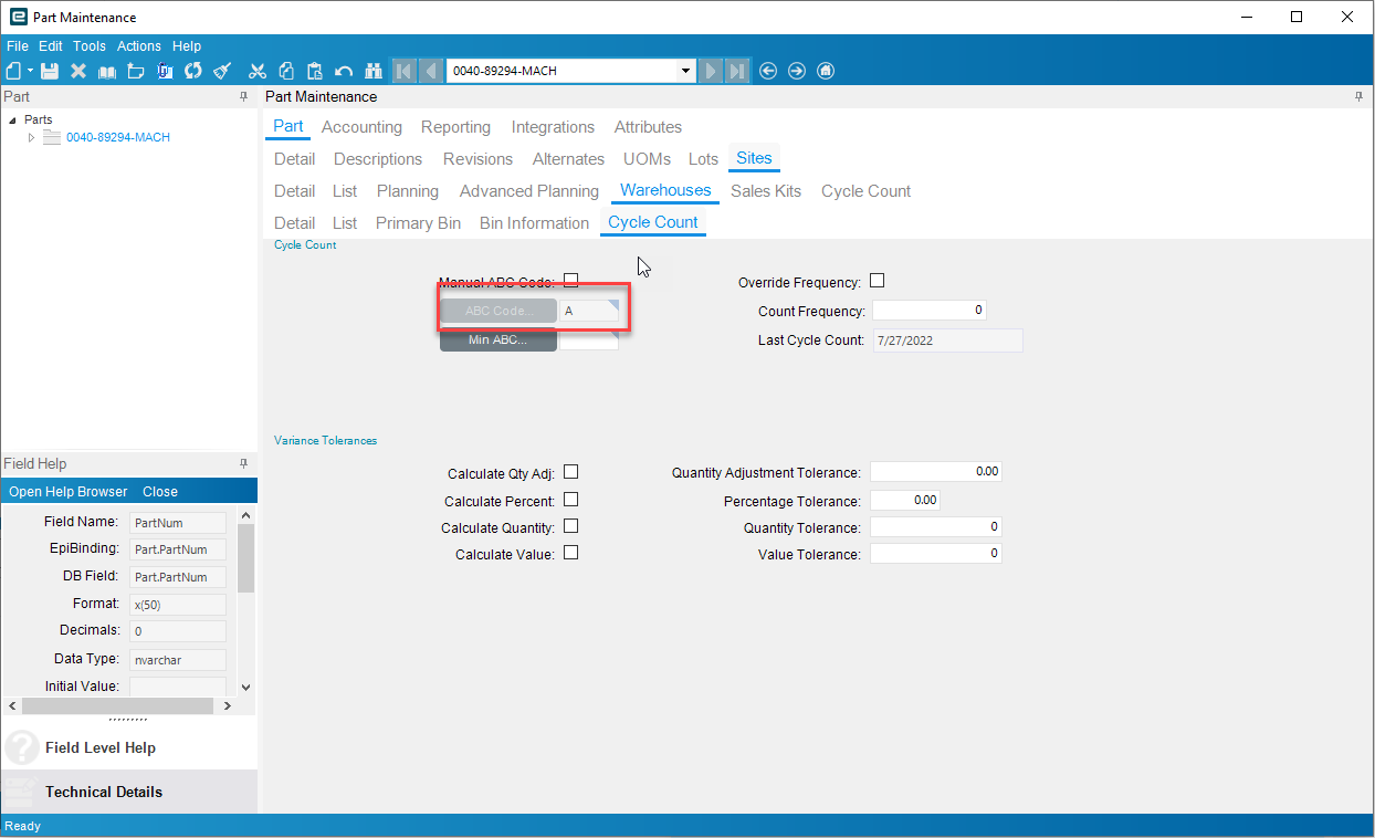

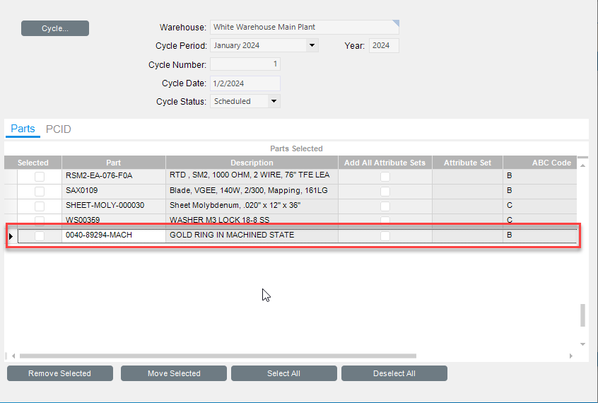

Thanks for that!, quick question you might be able to help me with I have a part tha tin part maintenance says its systemabc is A but when I add using the above menu you showed it populates as B, why would that be?
Is the part in more than one warehouse?
No, just 1
That certainly doesn’t make sense. Hmmm. Was it a B previously? Is there anything in the ManualABC field for the PartWarehouse record?
Im not sure if it was a b previsouly, how can I check that? No manual ABC code either
Only if you had the ChgLog enabled on that field I imagine. But you see where I’m going - maybe the cycle was created and the part copied and then it got changed. :person_shrugging:
