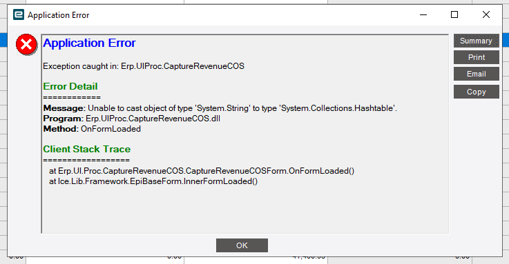

I’m working on adding an EpiButton to a dashboard based on the ProjectCst table: the aim is for the user to select one or more rows, then click the button to launch the Capture Project Revenue Recognition, passing the ProjectID(s) into the module. I attempted to code it in a manner similar to what I did last year with the Build Project Analysis.
However, that didn’t work, as it seems that the Revenue Recognition doesn’t accept a string as an argument or parameter, but instead calls for a hashtable, as per the error message:
Is what I want to do even possible? Here’s my code for the button:

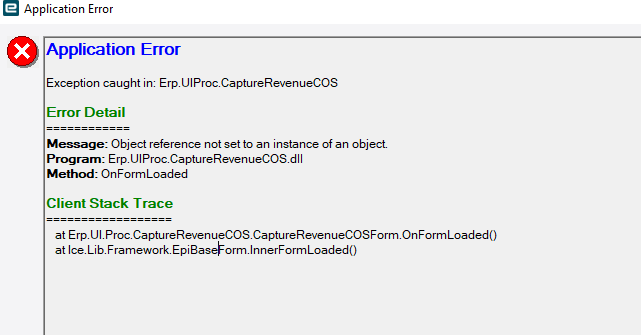

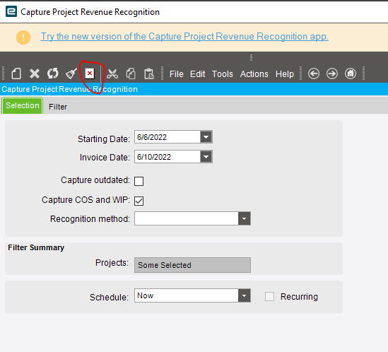

Did you run a trace on the revenue capture dialog, what does that look like for the project filter?
Here’s the trace when I run the revenue recognition normally, just clicking the button on Project Entry:

What stands out to me are: the “whereClause” in the ProjectImp.GetList method (indicating the two projects I selected), and in the CaptureRevenueCOSImpl.SubmitToAgent method at the end, seeing the “PrjList” data column ([CDATA[400740~400741]]).
This makes me wonder: do I even need to call up the capture dialog at all from my customization - is it possible to code it such that the projects are passed directly to the SubmitToAgent method within?
Yes, you can do this directly by interacting with the Erp.Proxy.Proc.CaptureRevenueCOSImpl business object. There should be examples on here on submitting to the system agent or calling RunDirect

Thanks for the idea, but it didn’t work…even if I hard code a projectID into the hashtable, it causes a similar error, except the message is: “Object reference not set to an instance of an object.”
Oh, sorry about that, missed this part
params.Add("CalledFrom", "");
The only logic I see for this field, is that if it is not empty it will disable the project list. I guess it means that if you are specifically calling this process form from another UI and passing a project, then you don’t want the user to be able to add more for processing.
That didn’t help either - got the same “Object reference not set to an instance of an object” error
Again, my bad, the key is calledfrom, not CalledFrom.
Hopefully that was the issue.
Awesome, that has helped a great deal so far, at least in getting the dialog to open with the selected projects. However now, upon hitting submit within the dialog, the revenue amounts aren’t actually getting posted (determined by looking in Project Entry hitting Retrieve under the Revenue Recognition tab)…though it looks like it’s running in System Monitor. What element could I be missing now?
I would wait for the process to complete and check what is logged to system monitor in case it is not posted.
To be honest I am not familiar with this process, you can try sending only 1 project and see what the process does, if nothing then submit it manually and compare what could be different if one works and the other doesn’t.
