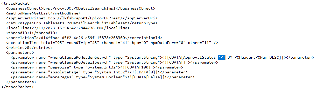

I have turned on the tracing and use the “GetList” but it doesn’t seem to detect the approval status. I also try to use the “update” method and some other methods that I found in the trace log. All don’t seem to work.

The changed field is only going to be able to know if it’s changed if it’s one of the methods that have 2 rows. (the unchanged and the changed). The get list method is simply a method to return something from a search. So there is nothing “changed”.

A good tool to be able to watch traces as they happen is baretail. You can open the trace and it doesn’t lock the file, so you can watch it as it’s writing the trace so you know when the call is actually happening. It helps trying to figure out if the call is actually happening when you expect it to.

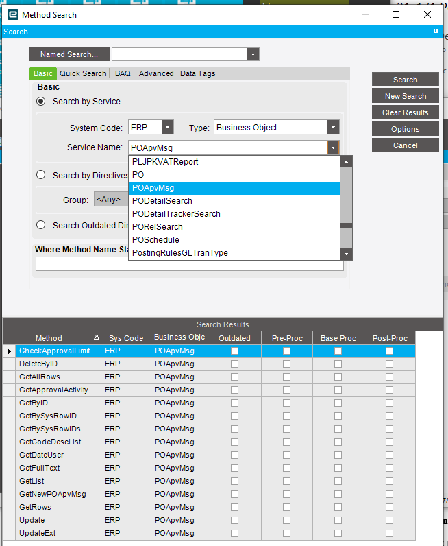

And to further answer your question as to how to track down what methods are firing, sometimes I look in the list of available methods, and make temporary BPMs on potential methods. Add a simple messagebox popup like @Banderson suggests to confirm it is firing.
Eg there are also these methods that you could check, eg POApvMsg.Update might be what you’re looking for.
