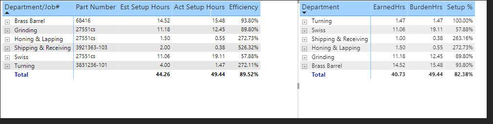

I am creating SQL views of an Epicor database and querying these views into Power BI to create reports.
There is a date slicer at the top of the page that is filtering both reports by Job Completed date. The data is fine, however the client would like both of these filtered by “the date the setup was completed”. I’ve searched the Epicor data dictionary and cannot find where this would be coming from; would it just be the latest LaborDtl date?

I think you need to dig into what they really mean by this. If your job has three operations, then there are three setups that could be complete or not. Do they want to know that setup is complete for at least the first operation, or that setup is complete for the last operation? (or some arbitrary operation in the middle of the job?)
In short, the setup dates are the labor dtl dates where complete is TRUE and labor type is S.
