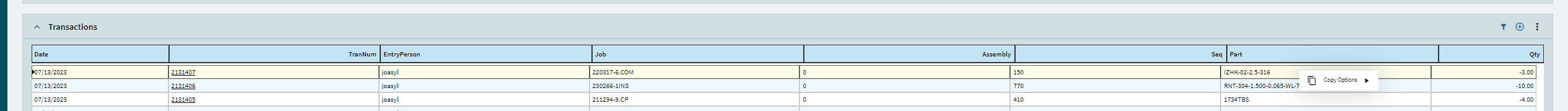

However, in both cases, I don’t see any ‘Open With’ when clicking on a column that has a PartNum for example. It works directly from the Business Activity Query menu but from my custom menu, it doesn’t. Is there any configuration somewhere in Application Studio in the grid object to do this?

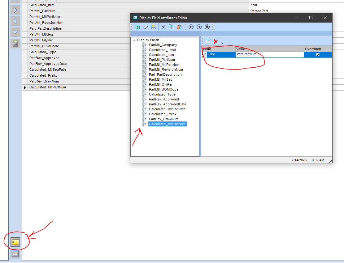

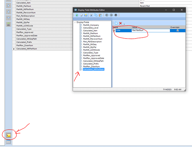

I would start on the BAQ… to get the Context Menu to populate, you have to set the “Like” value.
In your BAQ, Display Fields view… click the “tag” icon to open “Display Field Attributes Editor”.
Select the field you want… then see if there is a “Like” attribute. If not, add one in there.

It’s already configured like this since it’s JobMtl.JobNum or JobMtl.PartNum. In the BAQ, in the Analyze tab, it works. However, when adding the BAQ data to my grid via Application Studio, there seems to be no way to specify that

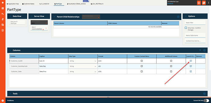

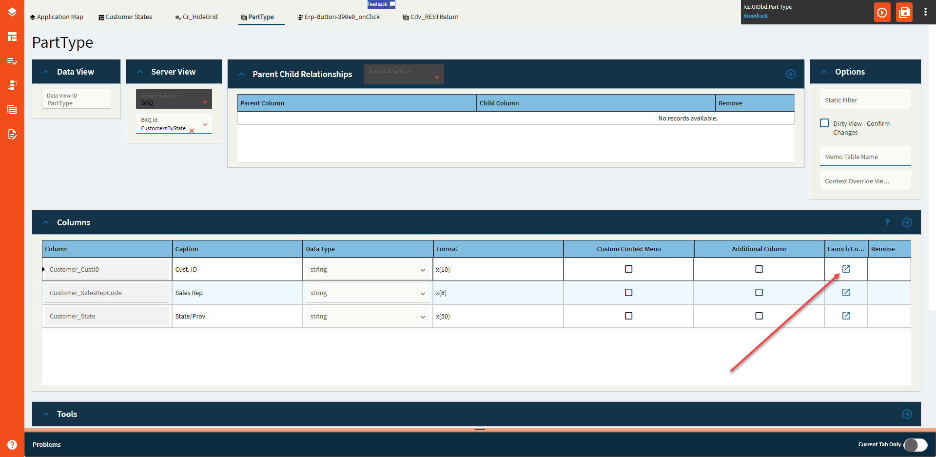

I see that option now but for some reason, whatever I enter or try, nothing works. Even opening the slideout is hard since it always move the grid up or down if I click on the ‘launch context menu’ icon :sweat_smile:

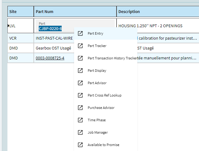

The only way to make it work is to make the column Editable (And read-only if you don’t want people to edit that field). That way, when you click on the row, you can then click on the column and the open with works with the same configuration as in the BAQ
Is that normal that we need to make columns editable to make the Open With works??

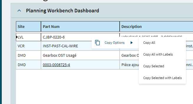

Not editable:
Editable:

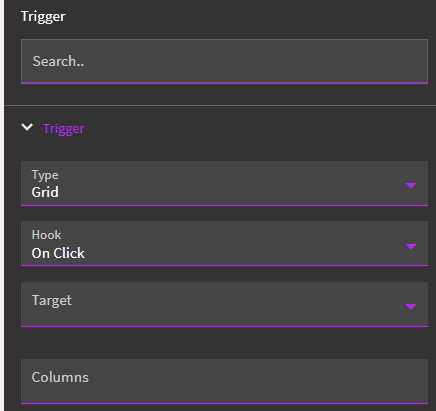

Sorry to necro this post, but we don’t need a whole new post for this. When you turn on IsLink, and the part number turns into a hyperlink, where do I access the onClick event for that?
You have to manually create it.
Would be a grid > on-click event trigger. You have to provide the Grid (Target) and column.
