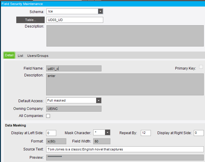

I wanted to create a custom field on the User table and use it to store the FDA password but it’s a huge pain setting anything like that up on that table so I just used one of the UD tables, UD03.
Key 1 is the user ID and the intentionally obscurely named ud01_c will store the corresponding user’s FDA password.
In Field Security Maintenance, I enabled Data Masking on that field.
