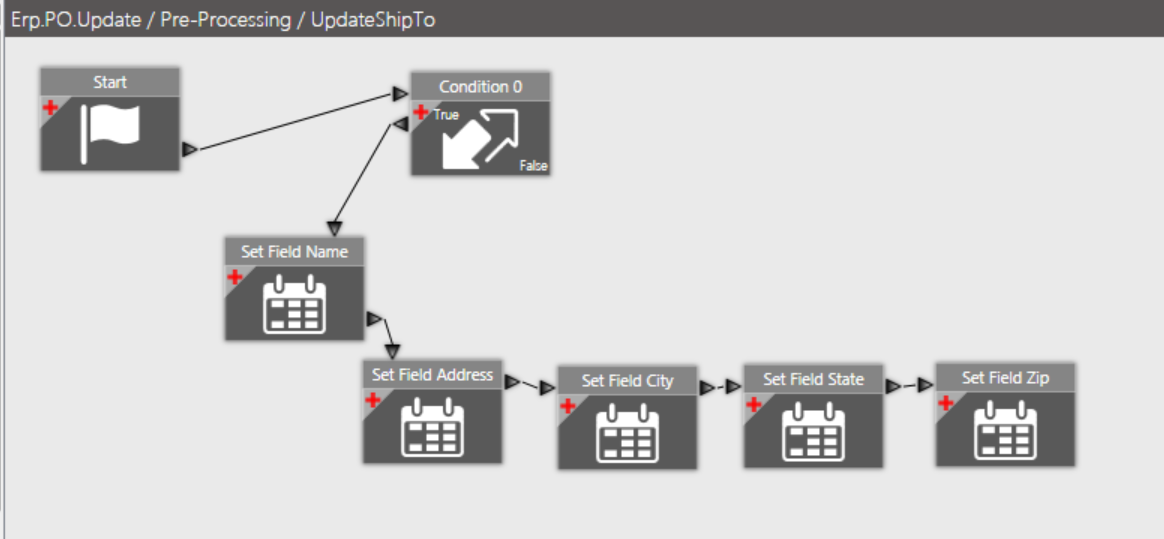

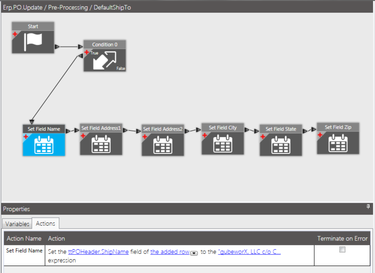

Hi, I actually just added a BPM for this in our test system. I am no expert on BPMs but it seems to work. Under method directive maintenance -> PO for the business object -> Update for the method. Pre-processing where the condition is a new PONum added to the POHeader table.
hi @jnbadger, what value you set in field Name, address, etc?
hi @tonid , i used POHeader.ShipName, POHeader.ShipAddress1, etc.
Thanks for your great screenshot :smiley:

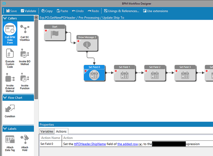

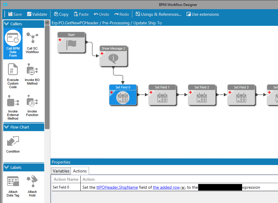

I couldn’t get the BPM to fire at all when I used PO.Update, but I can get a test message to display when I use PO.GetNewPOHeader. However, the fields aren’t setting…it’s still pulling the Site address in.
