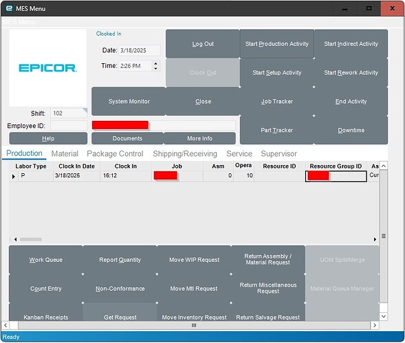

However, after doing all of this, I don’t know where to click at MES to test it (I’m not familiar with MES, as it is only for technicians to clock in & out of a job, but I would like to test out & establish the process flow in order to show the technicians how to do it later.
IS it not available at ‘End Activity’

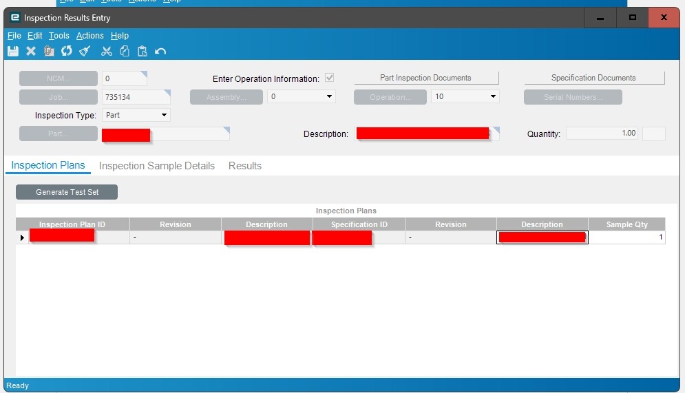

Unfortunately, no, unless I’m doing something wrong. The ‘End Labor Activity’ window pops up, if I click ‘Ok’ it closes the operation as completed, but if I click ‘Inspection Data…’ the ‘Inspection Results Entry’ window pops up, then I don’t know what to do from there.
At ‘Inspection Plans’ if I click ‘Generate Test Set’ nothing happens, then moving onto ‘Inspection Sample Details’ and click ‘Enter Results’ nothing happens either, finally at ‘Results’ clicking on 'Retrieve; nothing happens either.

In Classic, when you end activity on MES, there is an Inspection Data button, this will launch the screen, for entering the results
Before I did anything else, I made sure my plans, specifications & inspection plans were approved, which all were, then headed back to the Inspection Data button like you said, but my inspection prompt (which is a numeric input & has to be >0) never appeared. I don’t know if I’m missing something at a certain stage before this.
This is what shows up, a lot of stuff greyed out, and no input prompt.

  1. Click on ‘End Labor Activity’, and set ‘Current;’ at “1” (parts quantity) [VERY IMPORTANT] as sample size for this part is set at 1
  2. At ‘End Labor Activity’, click on ‘Inspection Data…’
  3. At ‘Inspection Results Entry’ & ‘Inspection Plans’ tab, click on ‘Generate Test Set’ [MUST NOT SKIP THIS STEP]
  4. Still at ‘Inspection Results Entry’, navigate to ‘Inspection Sample Details’ tab, and actually SELECT the ‘sample number’ row, then click on ‘Enter Results’ and voila!
The step that nobody ever told me was actually selecting the sample number and then click on ‘Enter Results’.
